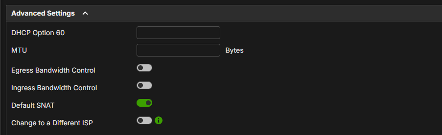

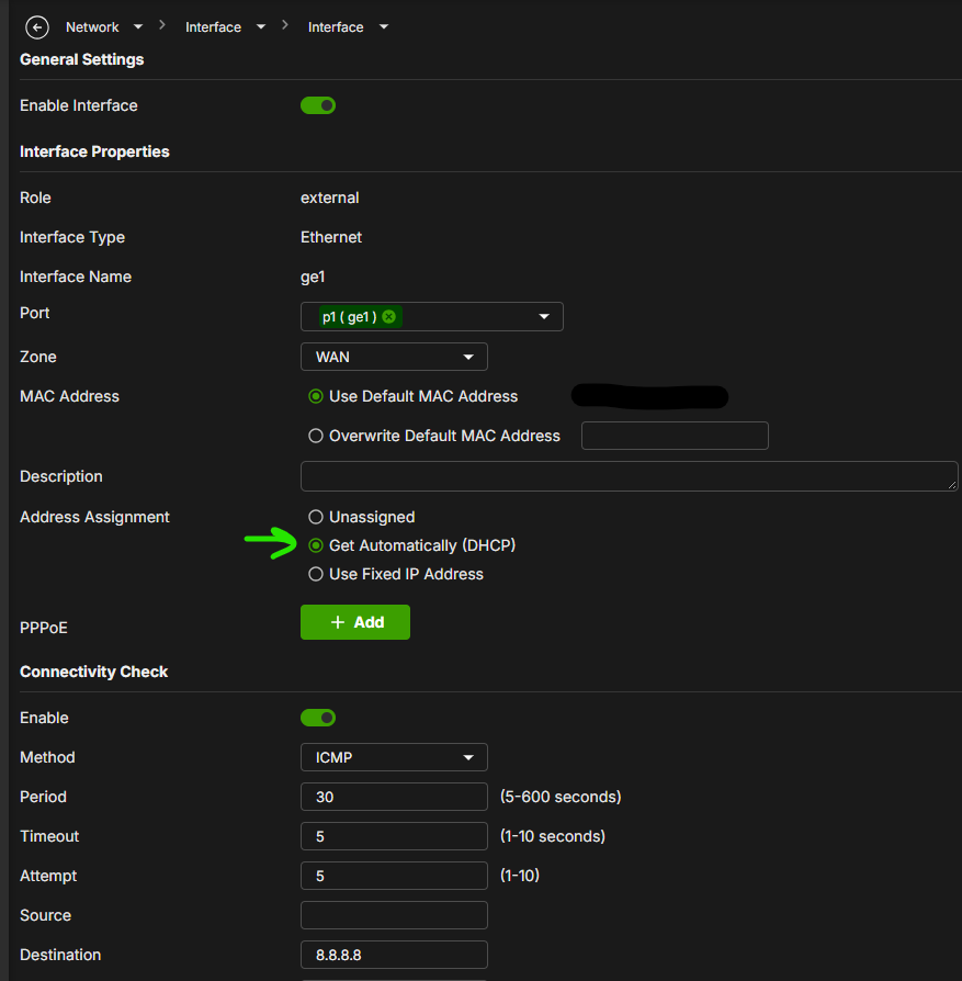

    It is a simple configuration.
    Port P1 is connected to an ISP modem that assigns a public IP based on the MAC address.
    It works without issues on v1.38, but on v1.39, port P1 fails to receive an IP; the ISP does not detect the P1 DHCP client requests.
