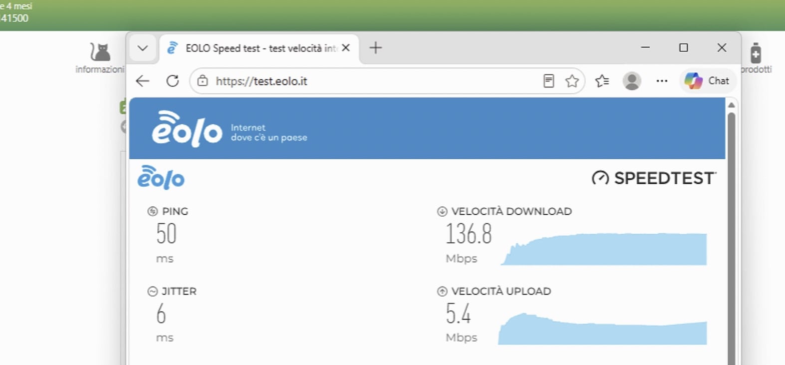

Hello everyone, I config a VPN for a site where I have a 50H.
I have 3x 50H in VPN configurator, everything work pretty fine among sites in VPN Orchestrator but I have a problem with remote VPN via PC.
This is the speedtest from a server on that site:
So outbound perf are fine.

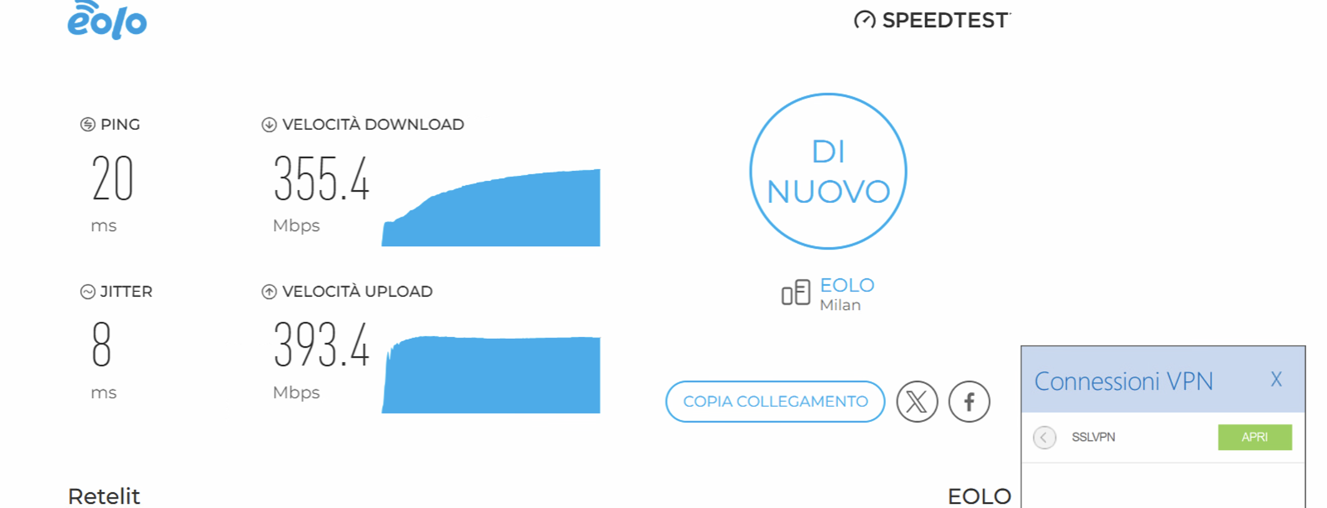

So I move a notebook from that site with 50H to an external site. I tested the external site perf:
As you can see I have VPN off (bottom right corner) and the ul/dl speeds are very good.

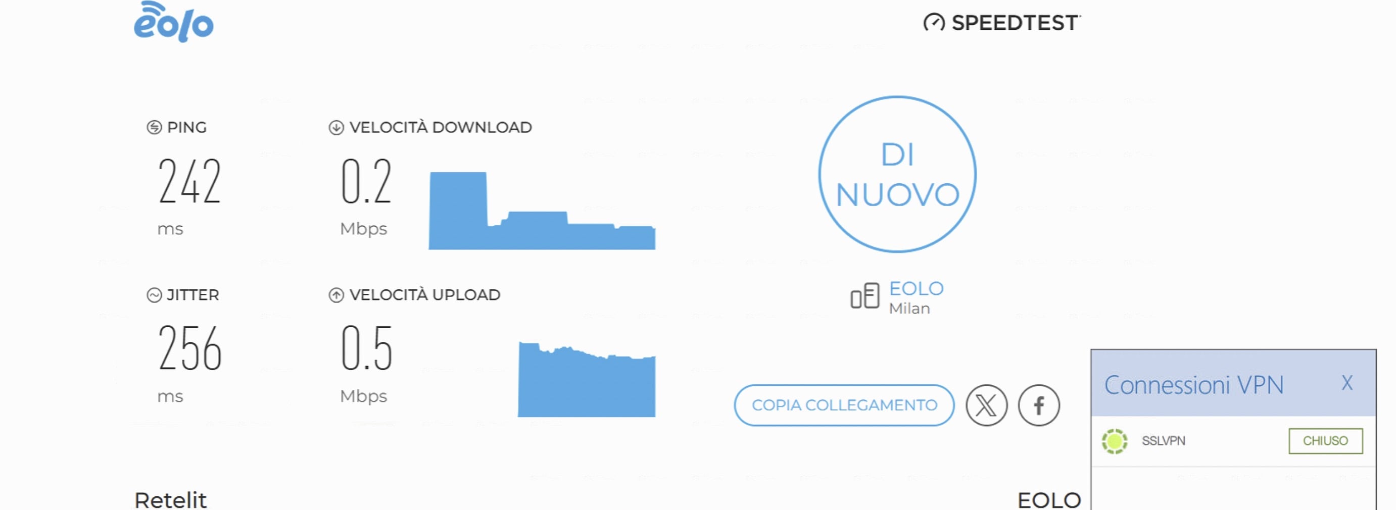

When I switch on VPN tunnel I see a huge drop in performance:
Totally bad in ping and dl/ul speeds.
This is related to VPN only, because without it everything seems ok.
How can I fix it?

    IKEv2 remote access VPN should have better throughput. Please help to use it for instead first. About the SSLVPN part, please allow me to check with our team first.

    SSLVPN is almost unusable with these performances.

    That does seem a bit slower then it should be?
    To test VPN without it going over the internet do a local VPN connection to FLEX 50H and do a speed test this way your testing VPN performance should external be rate limiting VPN tunnel

    I need to test it remotely to link a notebook to an internal server. Why testing it locally?
  • PeterUK
    PeterUK Posts: 4,796
    image  Guru Member
    Should external be rate limiting VPN tunnel meaning your speed test will be seen as normal but by a VPN tunnel locally to see the VPN real speed.
