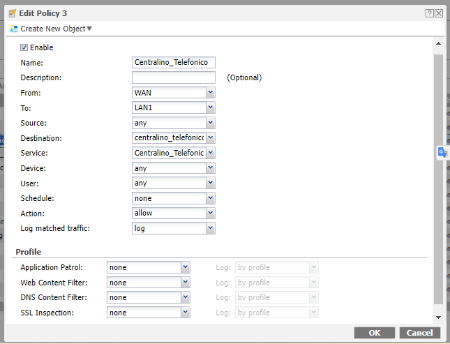

Post your Virtual Server rule and Policy Control rule

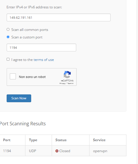

send UDP packet test here test you see incoming from WAN to LAN on USG packet capture
https://www.ipvoid.com/udp-port-scan/
0 -

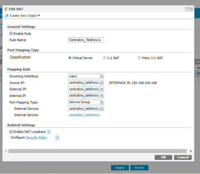

What's your application, could you describe more? I would like to know your NAT rules and firewall rules too, thanks.

la mia rete è cosi configurata:
0 -
The WAN1 IP is 192.168.100.168 which should not be the source IP.
Source IP means that only this address-object could go through this NAT rule. If you set it as any, it means any source IP address can access it.0 -

Here is my suggestion.
Incoming interface: WAN1
Source IP: any
External IP: WAN IP
Internet IP: internal server IPYou may refer to
0 -
problema risolto, grazie mille!!! ho utilizzato 1:1 Nat e tutto ha funzionato!
