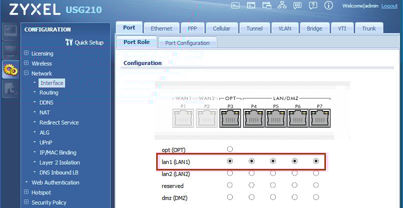

There was no problem with this on the USG 210:

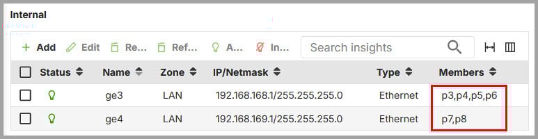

Default configuration:

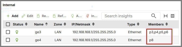

I can remove one port (e.g., p7) from ge4:

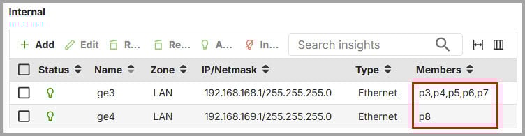

I can assign this port (p7) to ge3:

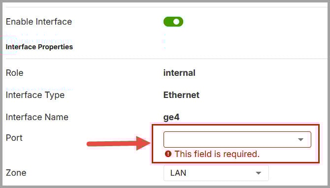

But I can’t remove the last port (p8) from ge4:

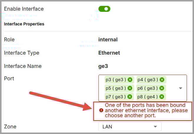

And since I can’t remove the last port from ge4, I can’t assign it to ge3:
Is it possible to assign all ports (i.e., p3-p8) to a single LAN subnet?

    Hi @Wojtek,
    you cannot have an interface without associated ports and you cannot have one port associate to more than one Ethernet interface type.
    So, you need to delete the ge4 interface (in this way you "free" all ports associated), and then you can add the port to the ge3 interface.
    If I remember well, for delete an interface, you need to remove all the associated references and by default (if I remember well) the default ge3/ge4 have a reference on a subnet object (but, for know what are the references, just select the interface and then click on "Reference")

    It worked. :)
    I have to admit that it was much simpler on the USG 210 - all it took was a single mouse click.
    Thank you so much for your help.
