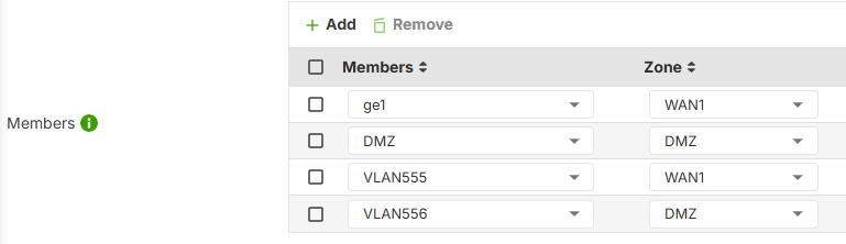

    So I have not tested for this I use bridge under Ethernet but need more info as to your setup
    so the bridge can't be set what VLAN but interfaces you add can however you can't do like VLAN555 WAN and VLAN555 DMZ and bridge them so you have to offset one VLAN555 WAN and VLAN556 DMZ and bridge like so
    So your tagged traffic goes
    router VLAN555 > VLAN555 (USG bridge) VLAN556 > VLAN556 switch > client
    so your saying you can't firewall this traffic?

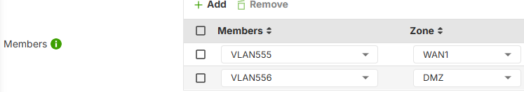

    Thinking about it you may need to bridge per two pairs of VLAN per bridge
