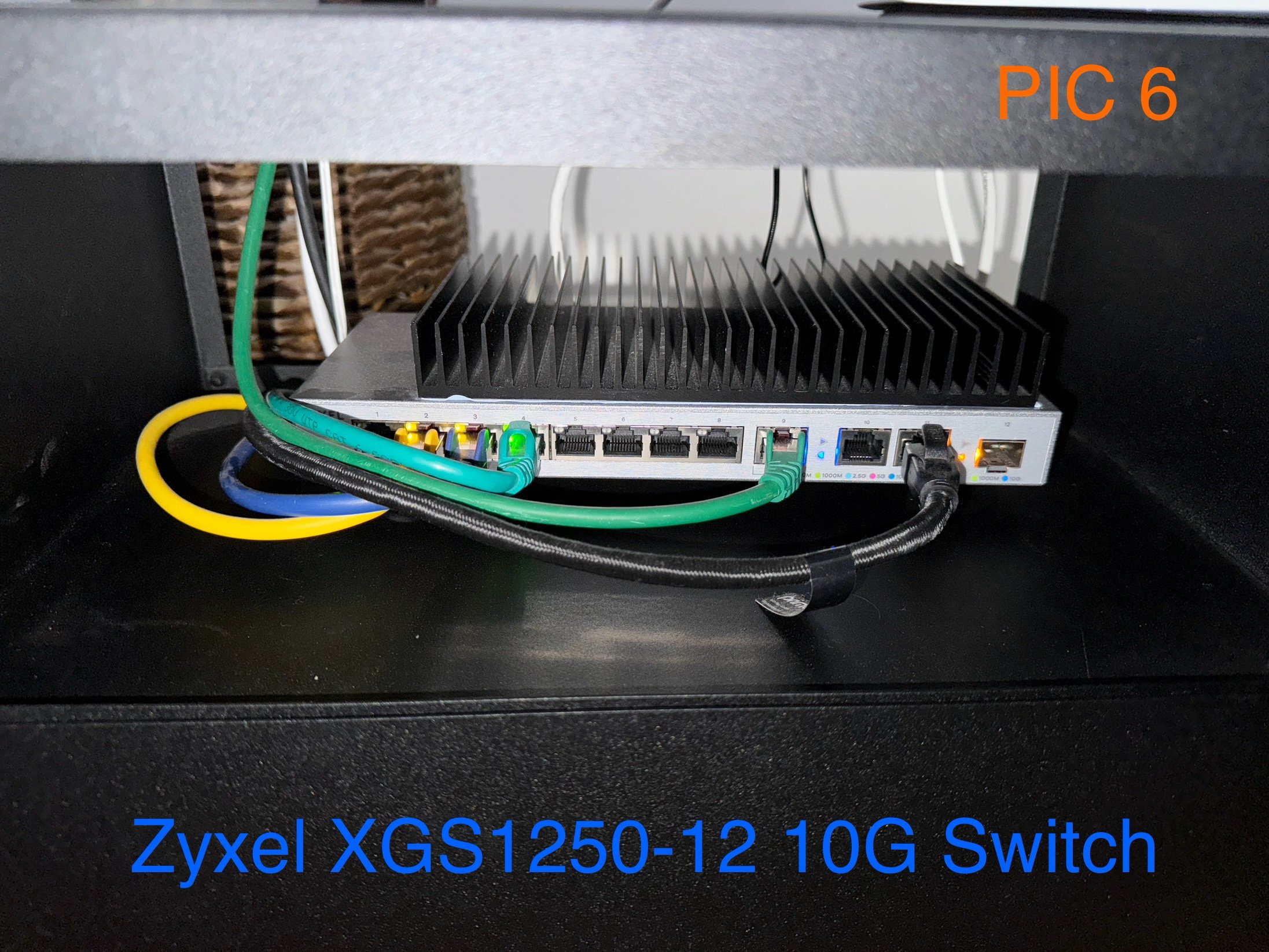

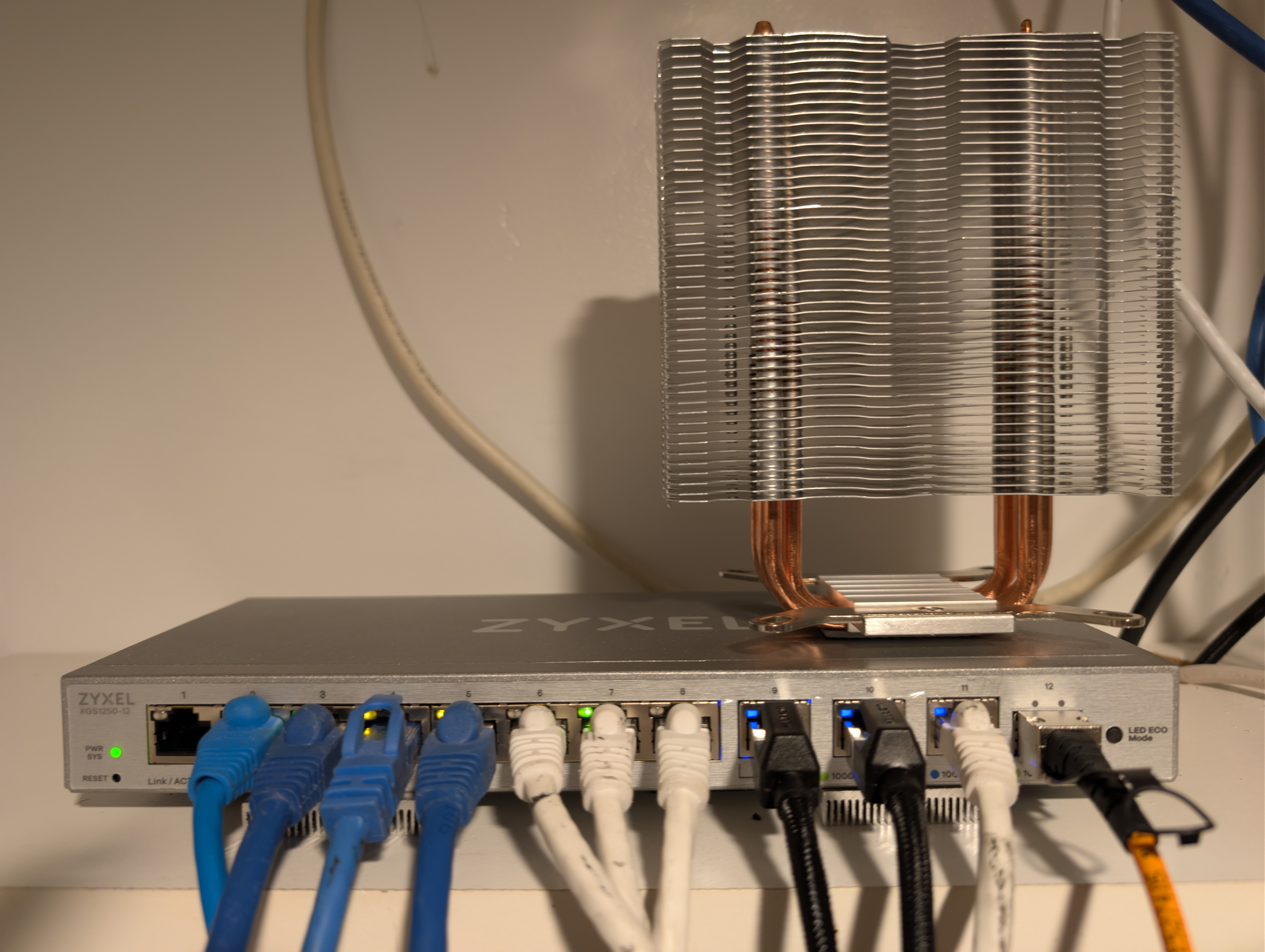

I ended up doing exactly this, I placed 5 pennies right above where the 10G port chip is. I put 0.5mm tape above and below each penny. Since they are copper, they seem to transfer a lot of heat to the exterior of the case. I also placed an old CPU heatsink with heat pipes on top of that same spot on the exterior. It seems to get quite warm so the heat is transferring through conduction well it seems. I originally had a smaller heatsink and that got quite warm, the later one is rather large and it seems to dissipate the heat well.
0 -

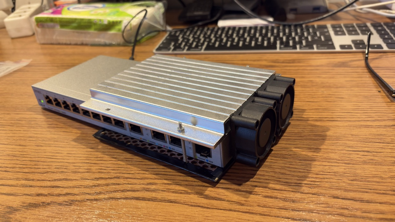

Hi, here is my solution to keep this switch cool.

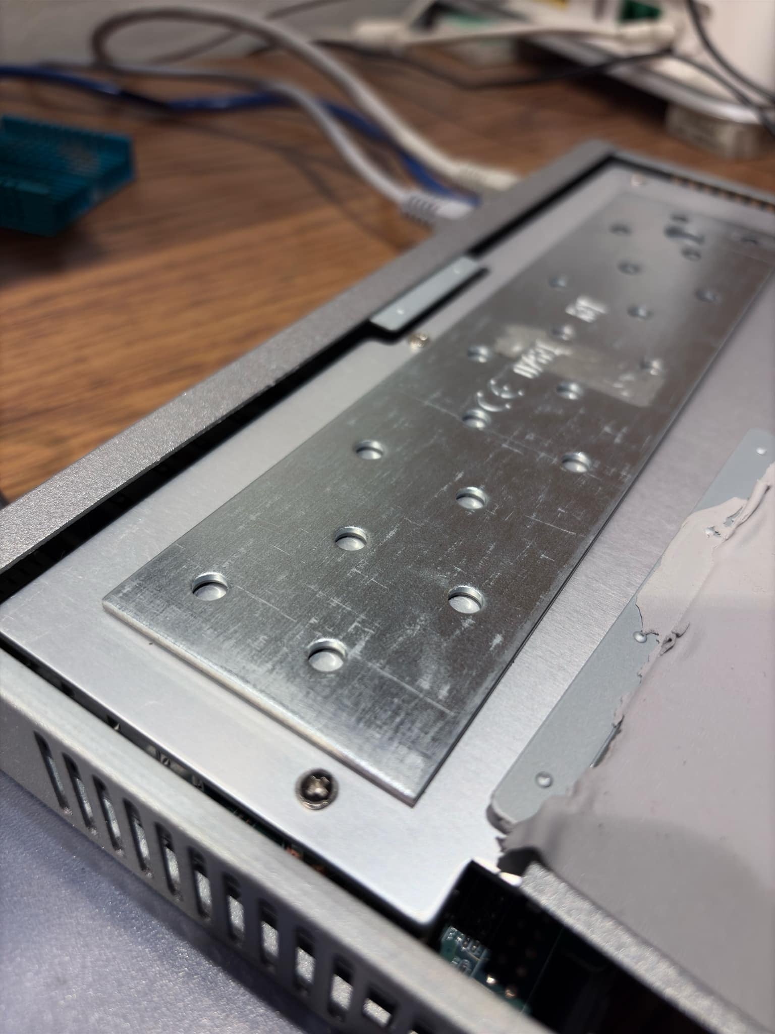

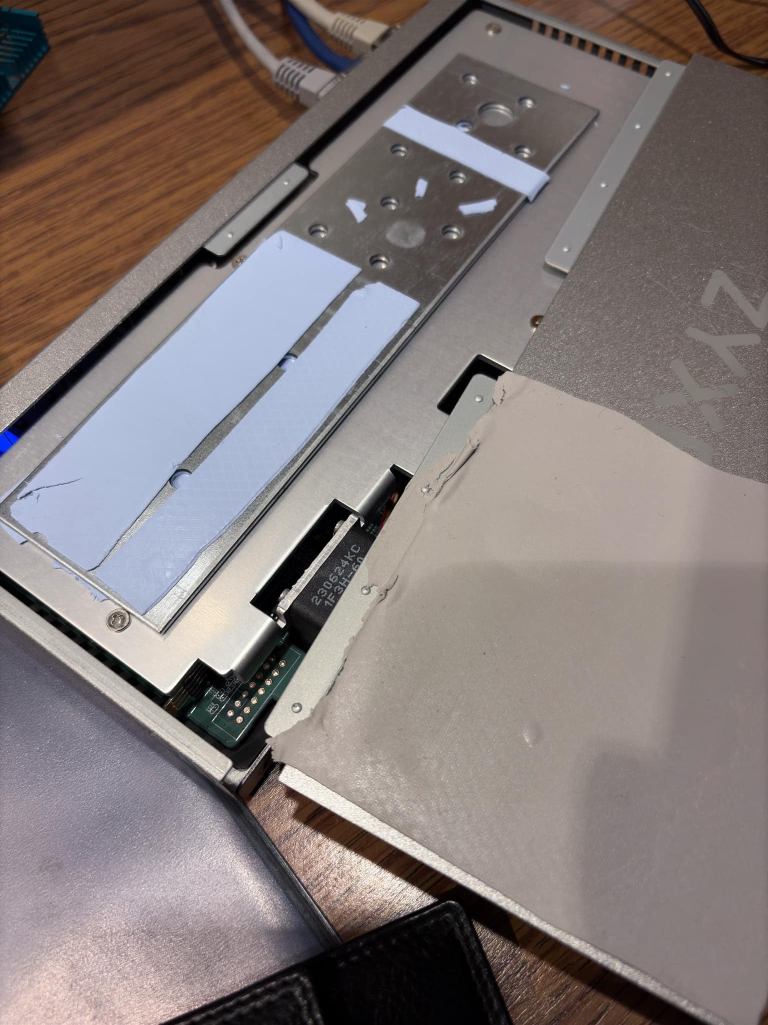

I placed an extra aluminum plate between the factory heatsink and the chassis with thermal pads to create thermal bridge.

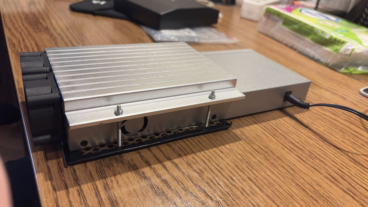

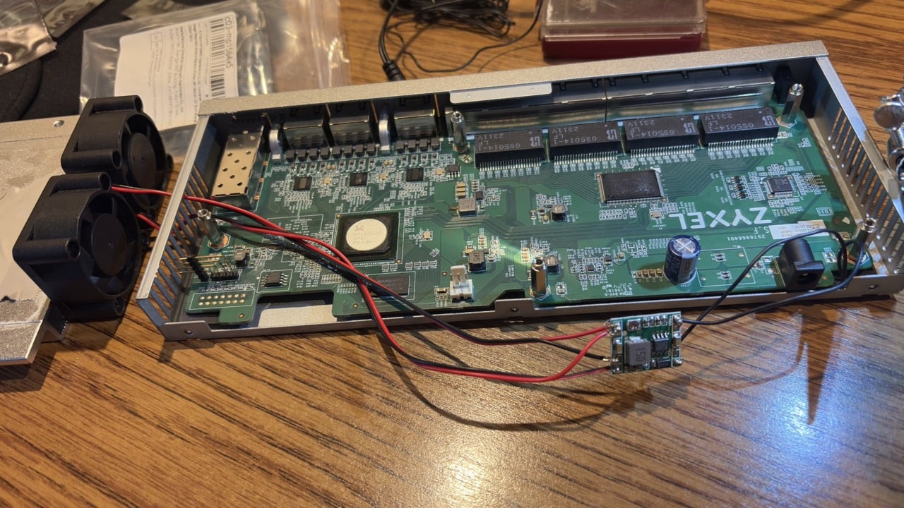

On the exterior, I mounted a Titan HDD cooler. (link)The fans are powered through an MP1584EN buck converter soldered directly to the DC input pins, with the voltage dialed down.
This setup forces air through the chassis and cools the entire outer shell at the same time.
