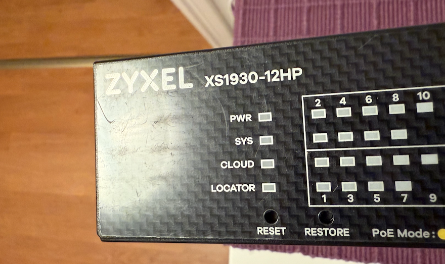

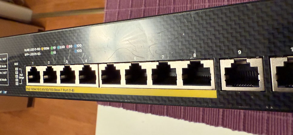

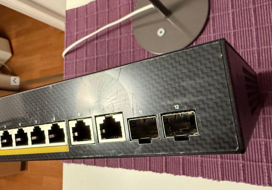

Hi @Zyxel_Judy
Just got a new one on RMA. Well… not "new".. It was heavily used and full of scratches and will go directly back with the supplied packing slip without being tested. Very disappointed.
I of course understand the unit I got must be working. But how many would accept such a heavily used and abused device as a replacement ? See pictures…
According to the amount of scratches it must have be abused a lot and used a lot! As the models have been around for many years, the replacement unit I just got can have been used for years. To then replace my unit that has been running for a month with a unit that can have been running for year, probably in a lab according to the scratches, that is not ok.
Is this a misstake or standard procedure by Zyxel? Let us hope it is a mistake by a single person and not standard by Zyxel…

Absolutely shocking! How can they send a replacement out in such poor condition?
I've had RMA's from other manufacturers and they've always been new units.

Hi @peos42,
Thank you for your feedback.
If the unit is a recently purchased item, we kindly ask you to fill out a new RMA request. When submitting the form, please have them include the following information:- Proof of purchase.
- The original RMA number.
- Specify that the request is for a DOA (Dead on Arrival) unit.
Additionally, when the support representative contacts you, please ensure they explain that the replacement will be a new unit.
Zyxel_Judy
0 - Proof of purchase.
Hi
I think that would ve very clear already as I uploaded info about my purchase (with purchase date on from nov 2024 it) when I did the RMA. Despite that, this is what I got. So with this in mind, what do think I should do?
And.. Now I am sitting here with my old original unit from nov 2024 plus the heavily used one I got on the RMA. So whatever happens, I have to send the one I just got directly in return with the packaging slip I got with it. So starting a new RMA again when the first one haasn't got in return could be messy. So I would need someone at Zyxel to handle it all. Not different persons… To add to that is my CLI license that has been moved to the unit that just arrived that I will send in return. This will cause me a lot of head ace.
0 -
Hi @peos42 ,
Apologize for any inconvenience this may have caused.
Please proceed with the steps above and include the note as "The request is for a DOA (Dead on Arrival) unit".
Thank you!Zyxel_Judy
