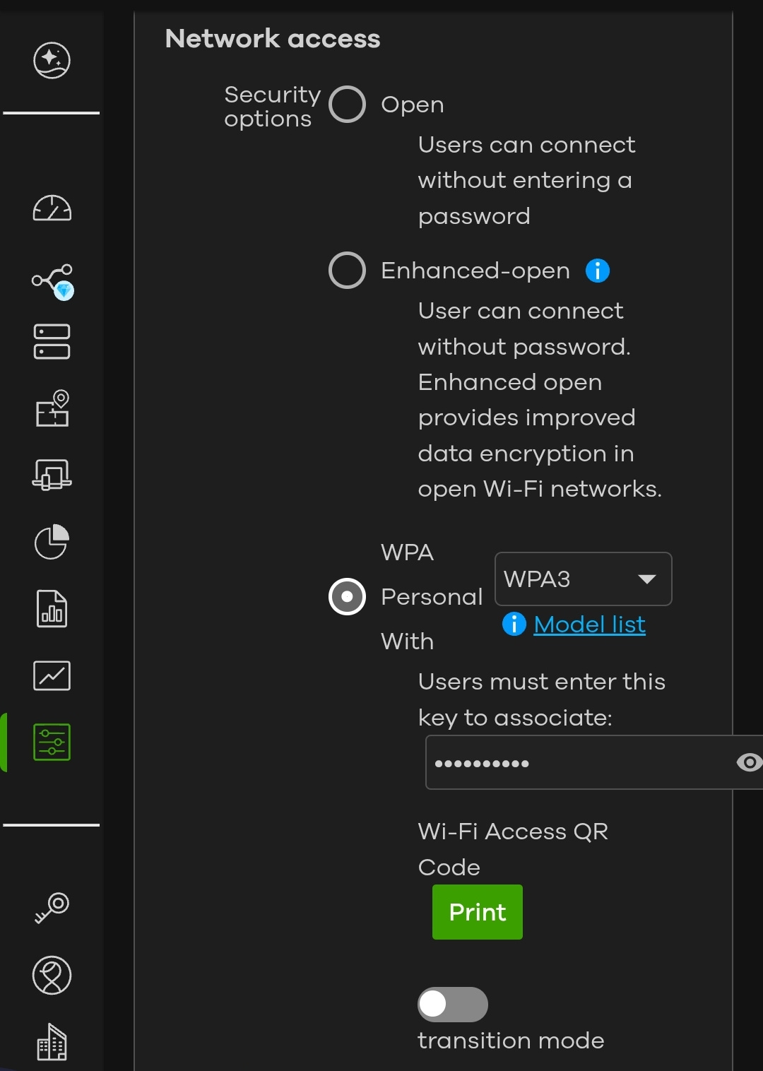

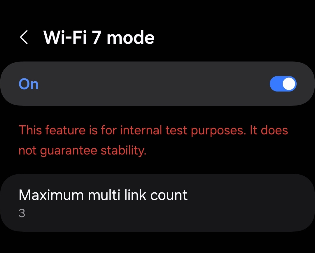

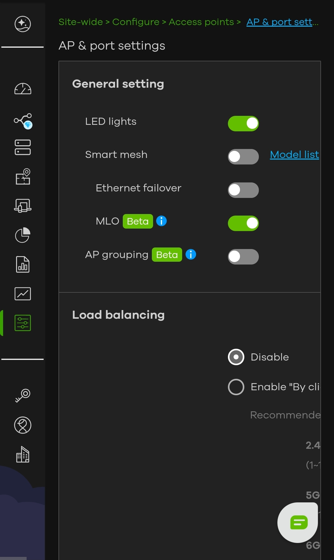

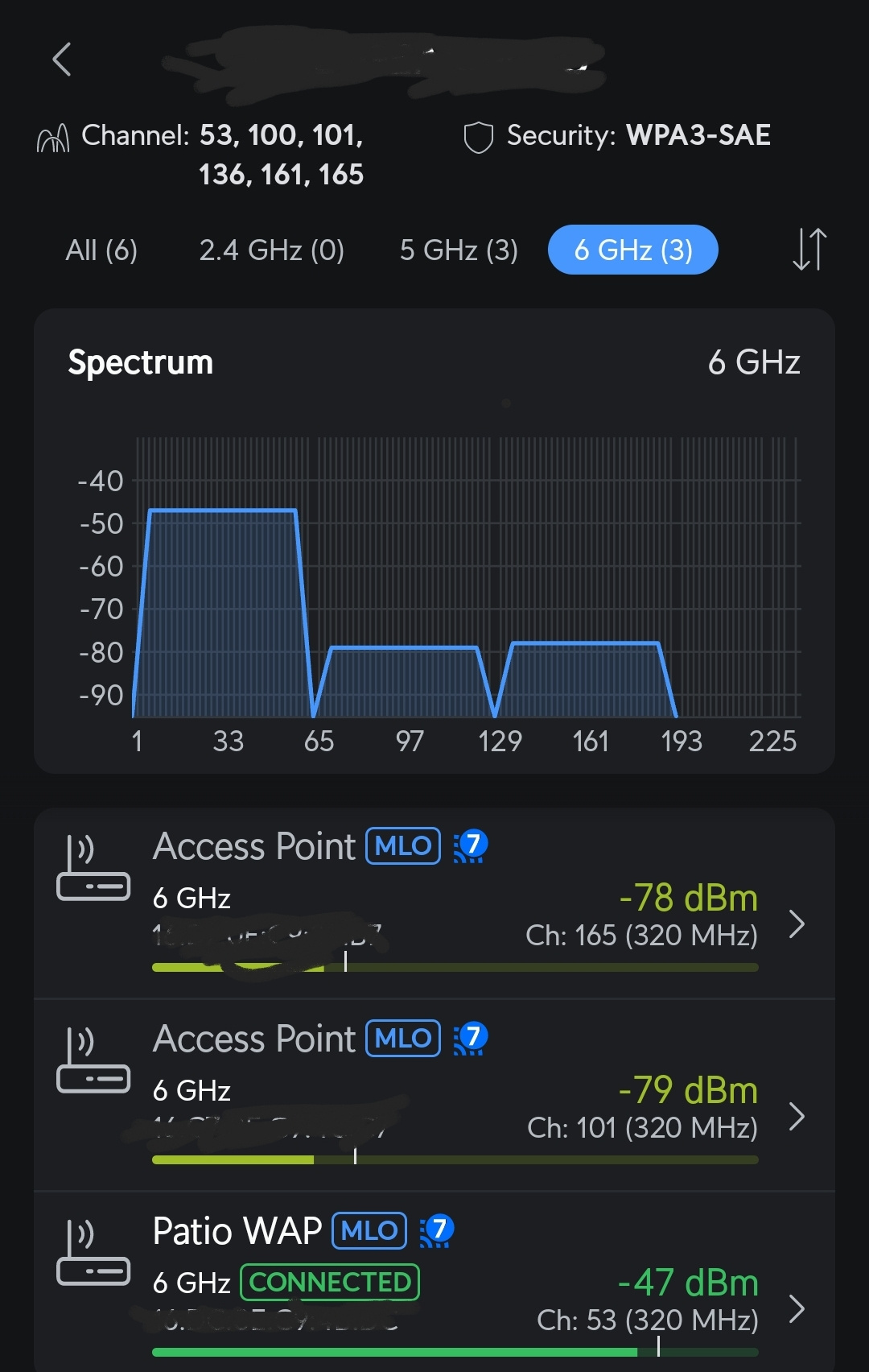

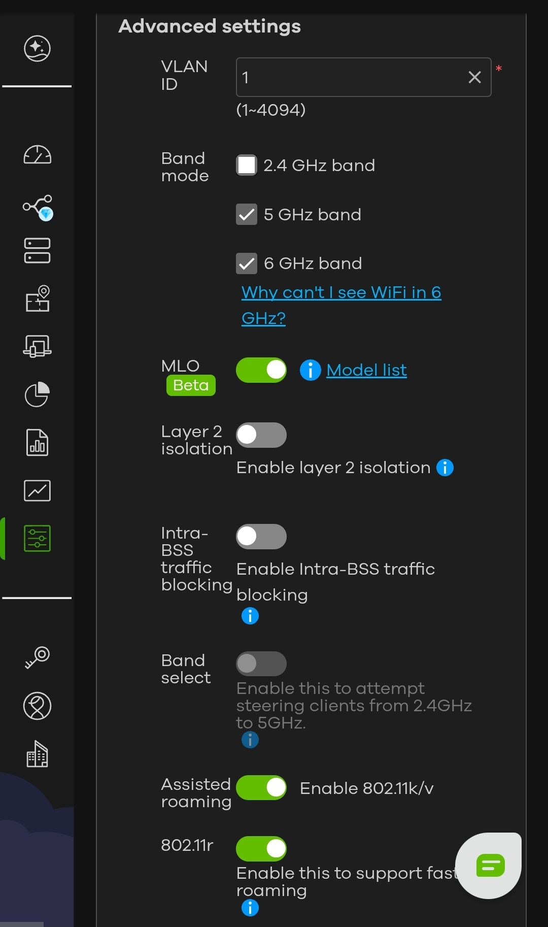

As shown in the attached pics, I have setup an SSID on the 3 AP's for 5ghz & 6ghz. I have the 6ghz set to 320mhz channel and the 5ghz set to 80mhz. The security is set to WPA 3 without transition mode. In advanced SSID the MLO option is selected. In the site wide AP&Port settings I have MLO selected. On the Phone under connectivity labs I have wifi 7 mode enabled and I have tried Maximum Multi Link count at 2 and at 3. I have included a wifiman showing that all 3 APs show they are MLO.

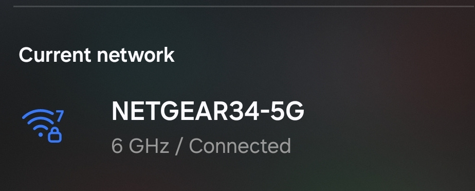

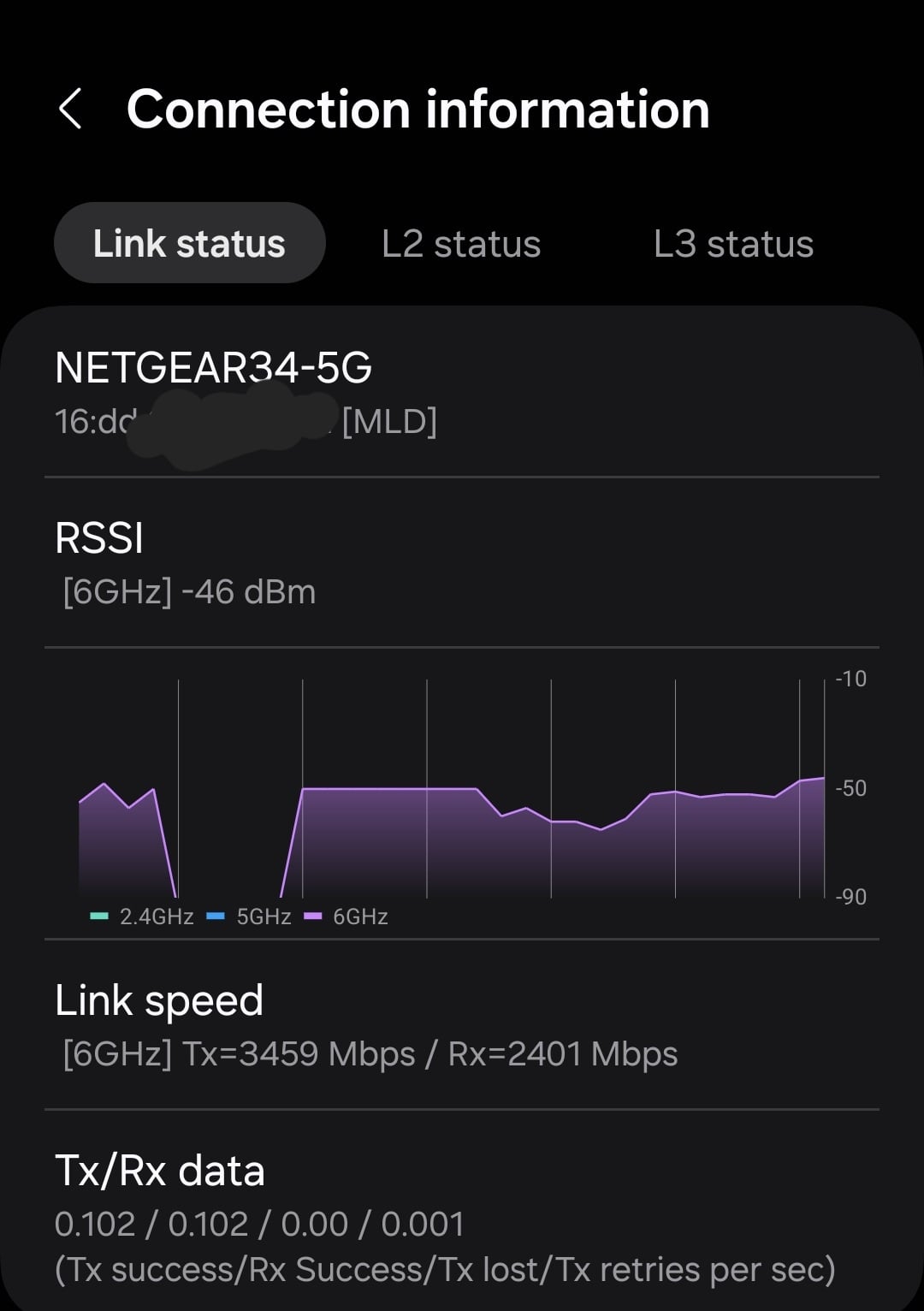

    Sending 4 screen shots.
    1. Shows available 6ghz + 5ghz MLO SSID I am going to connect to.
    2. Shows when I connect to the SSID it is in 6ghz.
    3. Shows my link speed, band info when connected to the SSID
    4. Shows the frequency, security type & MLO info of the connected SSID. Please note the MLO info. It shows Link 0 unassociated and points to the MAC address of the actual Zyxel NWA130be AP im connected to (this mac address matches the main mac listed in the Nebula app) Link 1 shows associated. This mac points to the mac address of the 6Ghz radio on the Zyxel NWA130be I am actually connected to.

    Hi @TallyTexas,
    Thanks for the privilege. After checking the connection logs, we found that the S24 Ultra only connected to one band (6 GHz) in the event log. This seems like the S24 Ultra's behavior cause it only displays 6 GHz on its WiFi status page.
