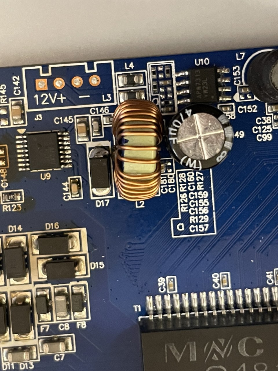

I’m facing an issue with a Zyxel GS1008HP, specifically with one of the power supply components — the choke. It hasn’t burned out, but it gets extremely hot during operation — the surface temperature reaches around 120–140°C, which seems abnormal and potentially dangerous in the long term. Input Voltage 52V,

  • There is no visible damage to the choke (no burns, no cracks), but I will attach a photo below for reference.

    I understand that the case is used for passive cooling, but the temperature of the inductor is extremely high — borderline critical. I came across a similar case on the forum (Link).
    As far as I can tell, the L2 inductor is responsible for stepping down the voltage from 57V to 12V. It doesn’t seem to be directly related to PoE delivery, but likely powers the internal logic or something similar. What's interesting is that the temperature of the inductor changes depending on the input voltage — when I supply 12–24V, the inductor stays cool. But as I increase the voltage, it gets significantly hotter. Of course, running the switch at voltages below the standard PoE range is not correct operation, but this behavior is noteworthy.
    Also, none of the other components on the board show any signs of heating — only the inductor. It gives the impression that the inductor might be saturating and heating itself, but this is just speculation on my part and could be incorrect.
    I tested it with zero connected devices and then with two PoE cameras — the heating occurs in both scenarios.
    I measured the surface temperature using a thermal imaging camera. While the exact readings may not be perfectly accurate, the choke radiates noticeable heat — you can feel it easily by holding your hand nearby — so I believe the thermal image is reasonably close to the actual temperature.
