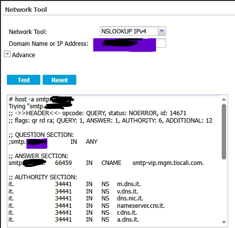

    It seems the firewall cannot send out the auth email
    Please check CONFIGURATION > System > Notification > Mail Server. Did you input IP address or FQDN for the mail server? I suspect it's FQDN, and the firewall cannot resolve it. You can test it by Maintenance > Network Tool > Nslookup, and check if the firewall can resolve the FQDN.
    Moreover, is the account local or external?

  • MassimilianoDelta
    MassimilianoDelta Posts: 28 image  Freshman Member
    First Comment Friend Collector Fourth Anniversary
    thanks but I try in Network tool (see pic) but message dont start
