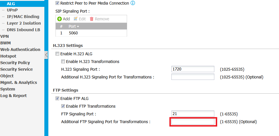

Not tried it but if you put 1990 in additional FTP signaling port that should work
0 -
Hello
i have already tryed but not works. Thanks
