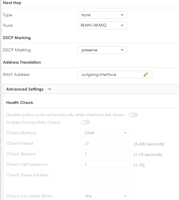

Hello everyone,
I went on the webUI with 1.32 version and I see this:
and when I try to select the desired trunk I see these options:
I cannot see where I can say to the firewall that a specific WAN is only for backup.
For example you have WAN1, WAN2, WAN3.
WAN3 has a limited amount of GBs for the internet traffic so I need to make a trunk for WAN1+WAN2 and I have to tell the firewall to use WAN3 only when WAN1+WAN2 is down.
Spillover is not a backup option.

    So did some testing here and my way will not work due to routeing override the interface ping check
    so either a change where by interface ping check override routing rule to fail it or when selecting next hop trunk ping check can be enabled and ping out interface listed in the selected trunk so that the routing rule fails to the next.
