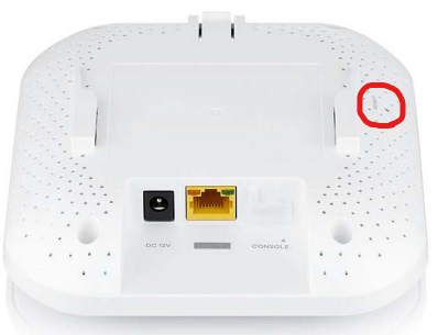

Hi @Montland,
How to perform a hardware factory reset:
- Make sure the AP is powered on and the Power LED is steady.
- Find the RESET button (usually on the back or bottom of the device).
- Use a paperclip or similar tool to press and hold the RESET button for more than 5 seconds, until the Power LED starts blinking.
- Release the button and wait a few minutes for the AP to reboot.
Once completed, the access point will return to default settings. You should then be able to access its web GUI using the default IP and set it up again.

Hi @Montland,
