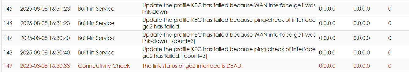

We have a Flex 100H with 2 WAN connections. On this router, ge2 is the active/primary connection, and ge1 is the backup/passive connection. Previously on 1.32, when the primary connection went down, the DynDNS address updated appropriately to the backup address and routed internet traffic out the backup WAN connection.
After the 1.35 update, we had an outage affecting the primary connection today. While the failover happened and all computers were routed out the backup WAN connection, the DynDNS address did not update. We got error messages about GE1 being "link-down" when this is the backup internet connection that is fully up and operational, and what is being used to route the computers out to the internet:

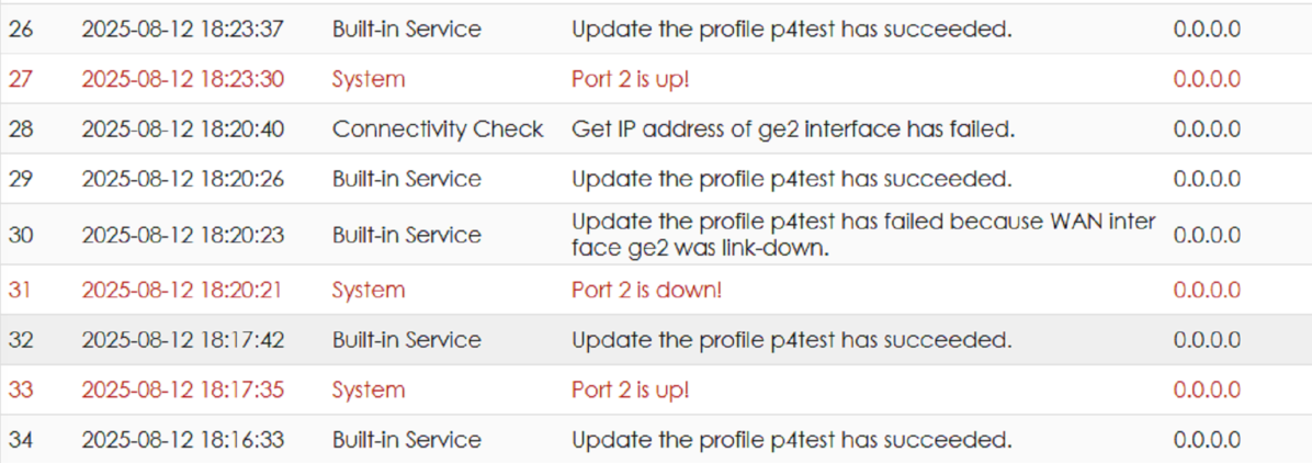

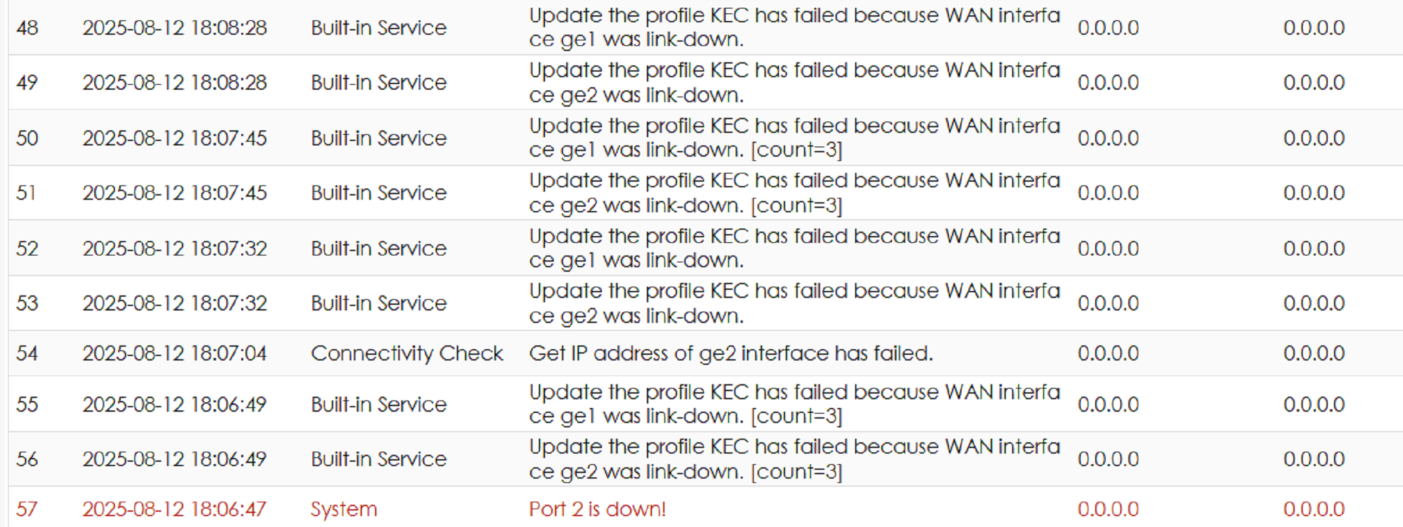

    Did a bit further testing on this, and it could potentially be an issue with the number of characters within the DDNS address? We were using (17 characters).dyndns.org, and for testing we setup one that is (6 characters).dyndns.org. We use the DynDNS type and tried with the Interface and Auto options. Even tried recreating the DDNS profile to no success.
    WAN Trunk setup with ge2 as Active and ge1 as passive. Connectivity Check setup on ge2 interface.
    Applied the same configuration to a different router for testing purposes. No matter if we tried to kill the Primary connection or manually update the DDNS address, it failed:

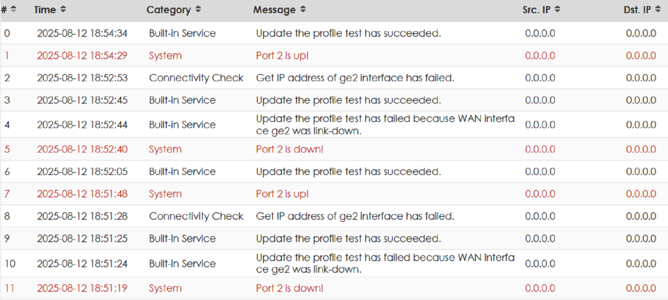

    However, with the shorter DDNS address , this is working exactly as expected and using the backup interface to update the DDNS address:
    Update
    After testing again with a new DDNS address (test123test123test.dyndns.org), everything seems to be working with this longer DDNS name.
    At this point I guess I am not 100% sure what the issue was with the old address, but we can just use the new/shorter DDNS address
