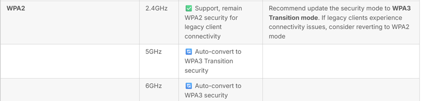

However, one important consideration for WiFi 7 BE mode access points is that with firmware version 7.20 and later, there is an automatic security protocol upgrade behavior. When the security option is configured as WPA2 on the 5 GHz band, the system will automatically convert it to WPA3. Users should be aware of this automatic conversion when planning their network configurations, as it may affect compatibility with older client devices that only support WPA2.
Here is the link regarding the new behavior with the release of the new AP firmware 7.20:

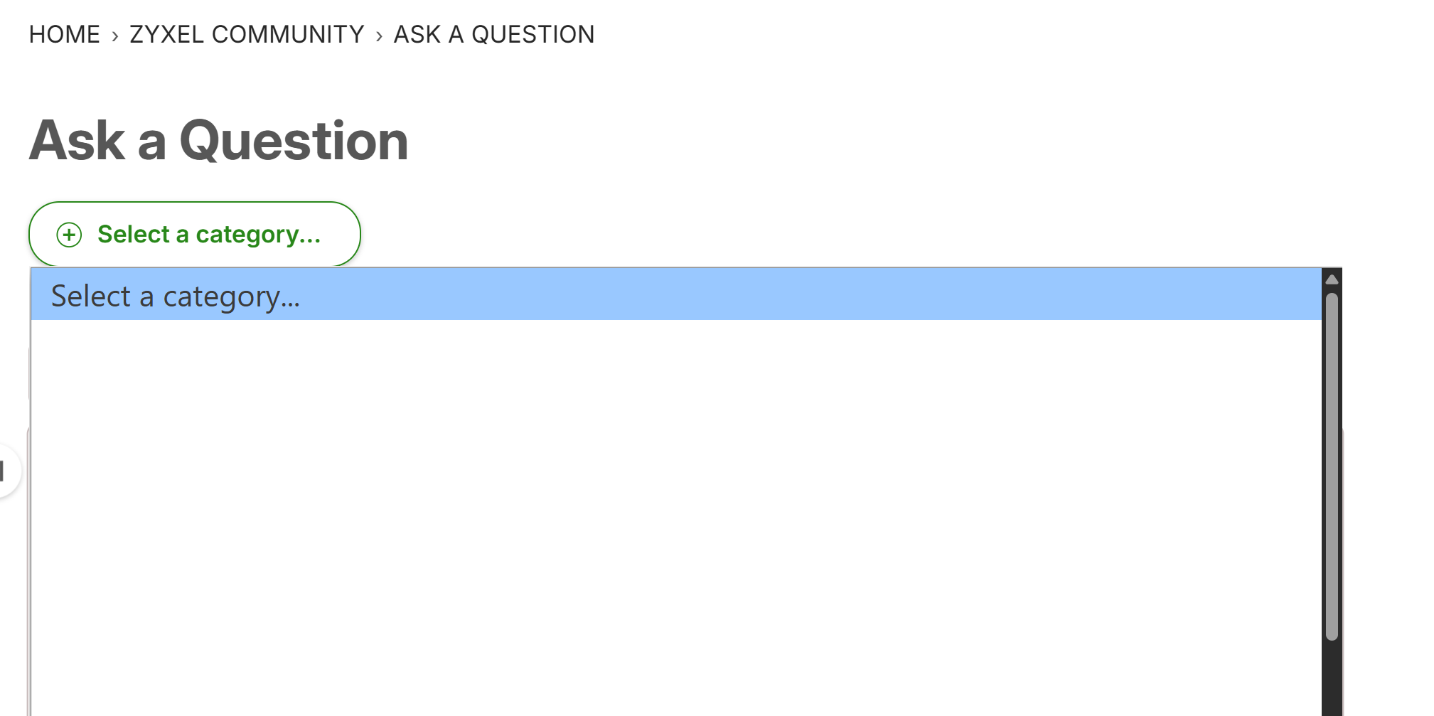

I wanted to open a new question, but the system does not allow this. I need to select a theme but there is none to choose from! Without a category selected, I cannot post! Please fix.
