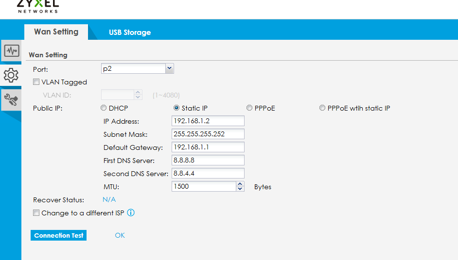

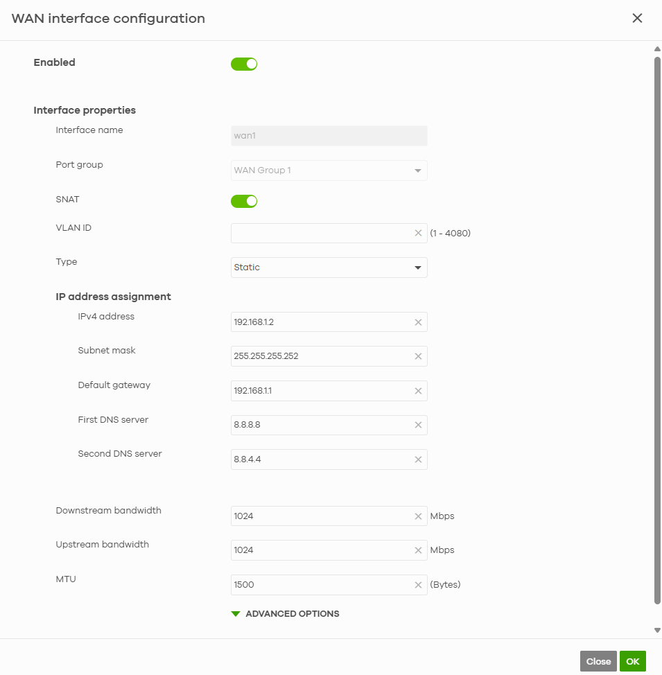

I have a similar setup, and it works just fine. I didn't change the subnet on the internet box, so it stayed at 192.168.1.0/24. Did you set DMZ to point to the USG?
If your USG isn't connecting to Nebula. Log on to the USG and change the settings there:
You'll need to use 192.168.0.2 and 192.168.0.1 accordingly.

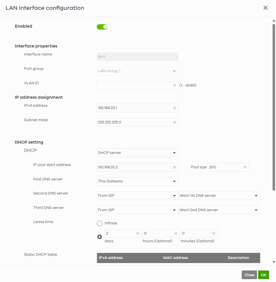

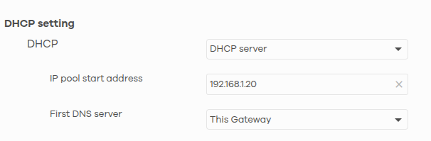

dns-1: this gateway refers to the text in Nebula's LAN interface configuration modal:

Your last image shows what I assume is the USG's own internal server however that is not available once the device is configured for Nebula. This is not something I can easily correct, as I've no idea how to restore the native mode for the USG (an no - I neglected to backup the various configs first), and I'm not entirely sure I fancy managing the USG in this way. Nebula does seem a lot simpler.

dns-1: this gateway is essentially exactly what is stated under the LAN interface configuration on Nebula:
