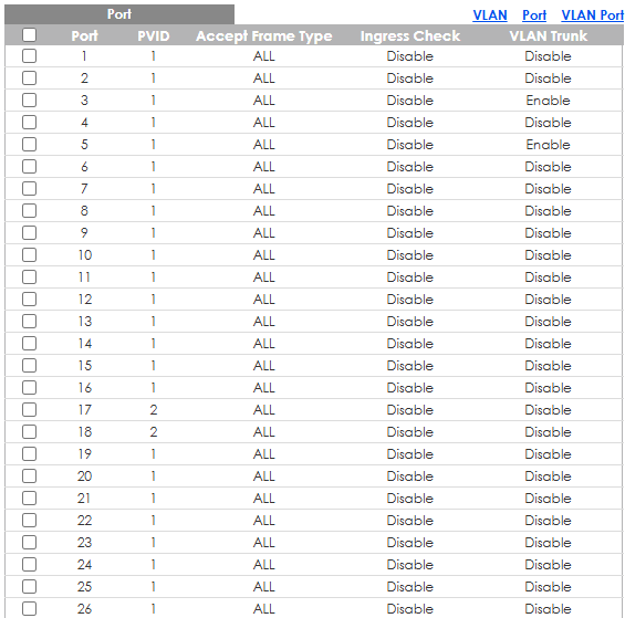

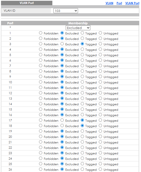

The current configuration on the new VLAN, with port 3 being my trunk line, and 17/18 my direct connections to my router. 17/18 are solely associated with VLAN103, wheras 3 - being a trunk - is tagged in pretty much everything else:
I have not activated any port isolation, as - from what I understand - this would prevent any trunks from working, which would defeat the point of what I am trying!
I have attempting to create a PVID for ports 17/18, which seems like it could have been a fix according to other forul posts, but this did not seem to fix the issue:

Hi @jnoyMIT
Please reference this FAQ first:
If there still have question, please share your topology. It would be more clear for us to understand your network and give you some hint.
Zyxel Melen0 -
In addition, if your router doesn't support VLAN (can read VLAN tag), you should set untagged on specific VLAN, and set PVID with this VLAN. Also, does your second switch supports VLAN?
