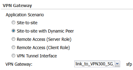

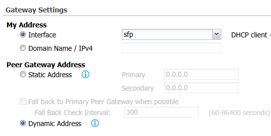

in stadnalone you set to Dynamic Address then set Site-to-site with Dynamic Peer

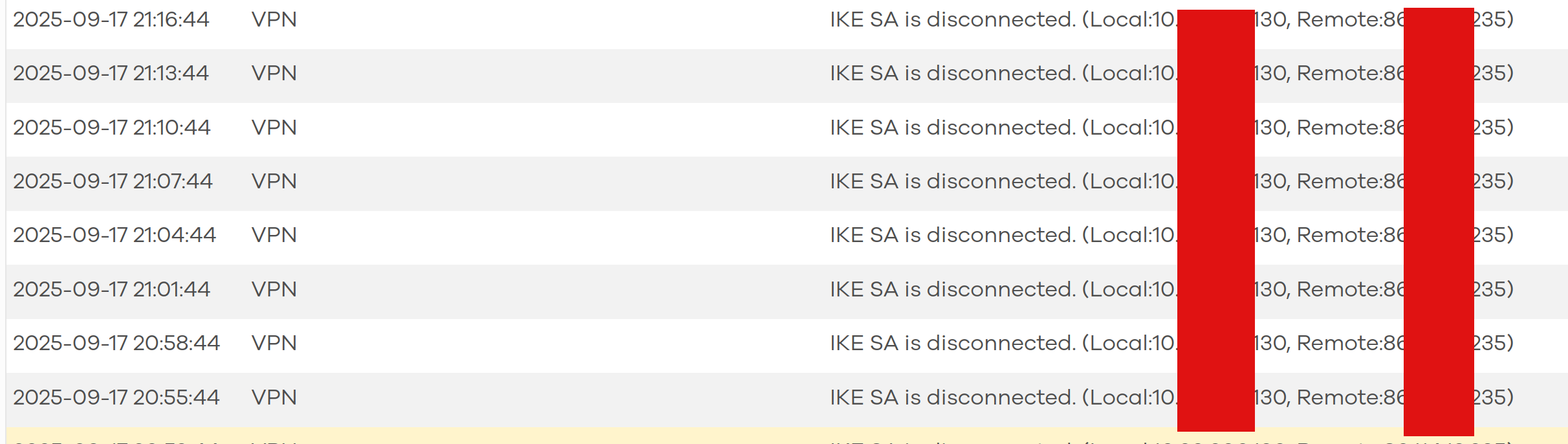

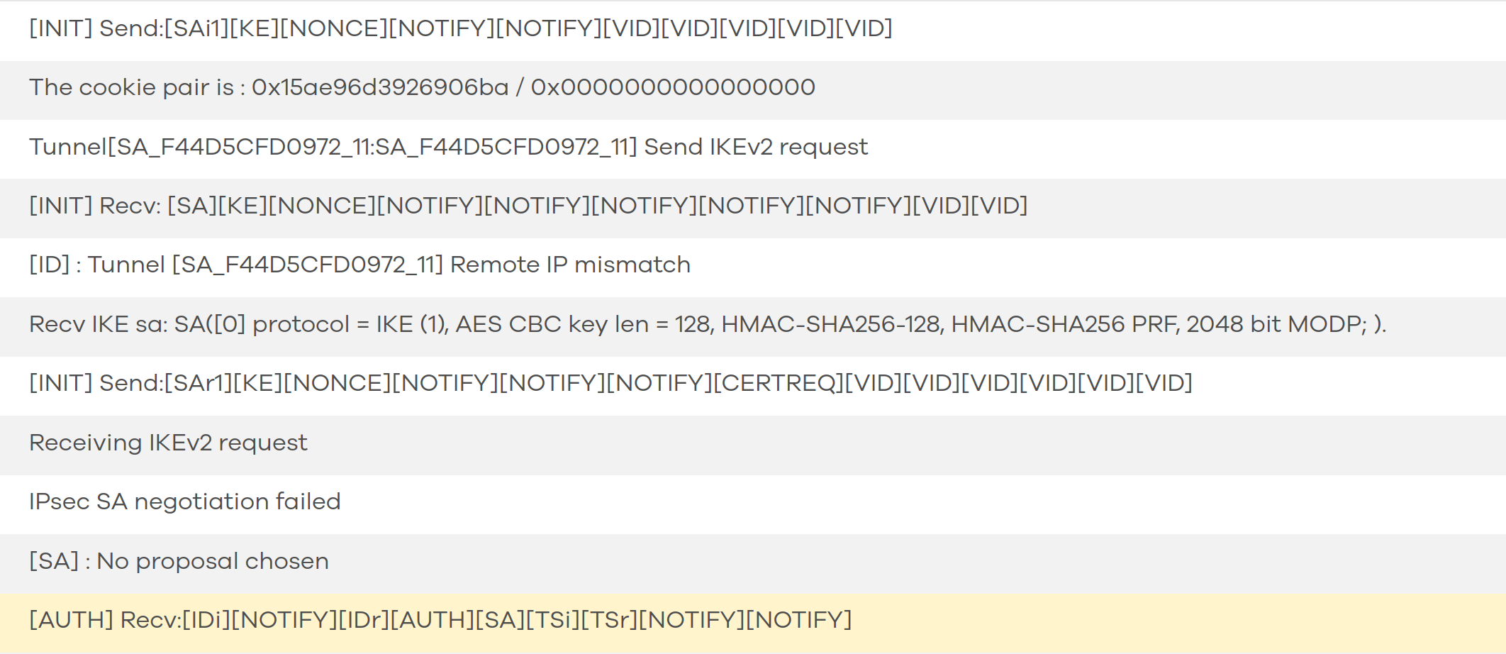

I had the 60AX off for several days. After that, when I powered it on, there was first a partially connected VPN, until it failed again. I attach a piece of log:
Establishing the tunnel starts, but there is a message of "Remote IP mismatch", and after that the firewall (FLEX100) tries to connect directly to the private IP behind NAT. On the 60AX side I can't find the setting to set IKE to use the dynamic dns to use as local IP.
