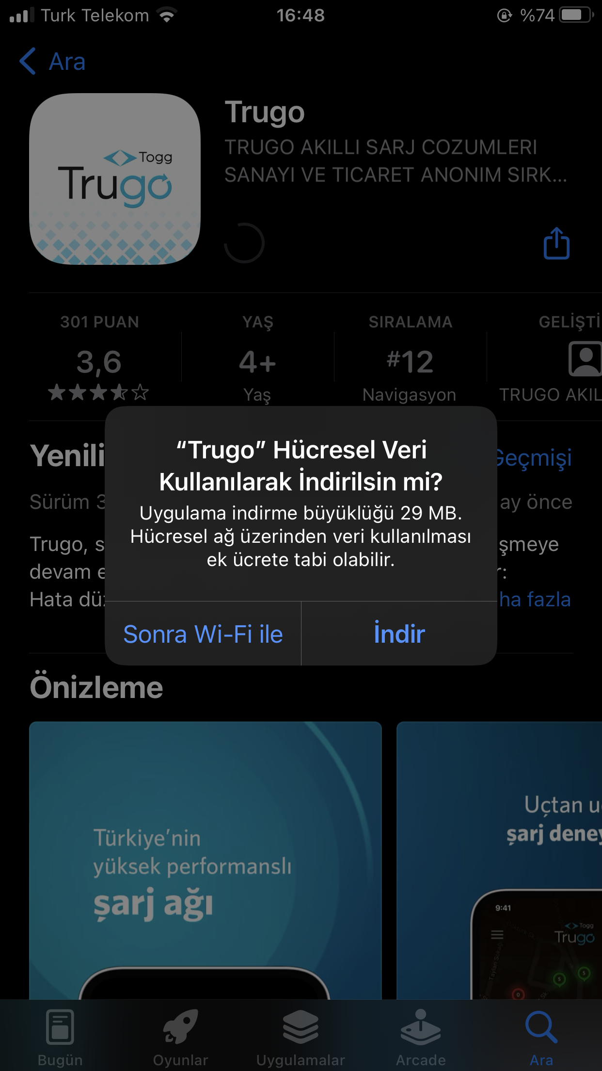

I've backed up my iPhone 11 using the modem (ZyXEL EX3501-T0) connected to Türk Telekom fiber internet, and I can't even log in to the iCloud login page while connected to Wi-Fi. In addition to all these issues, I've been experiencing Wi-Fi disconnection on all my phones as soon as I turn off the screen. I've been trying to find a solution to this problem since the day the modem was connected (about 1.5 months ago), but there are very few resources online, and the ones I've found either offer solutions I've tried before but haven't been successful, or they have no solution at all. I suspect the problem is with the modem, and I'm asking for your help.
In the picture, it says "Should apps be downloaded using cellular data?" even though I am connected to my modem.

    I have the same problem. My phone and other devices see the unlimited Wi-Fi network as a mobile hotspot. Because of this, apps like Google Photos, WhatsApp, the Google Play Store, and others don't automatically back up, download, or upload. I found the modem's user manual, but I couldn't find any settings. I have a 9th-generation iPad, a Samsung A54, Samsung A72, Samsung S10+ all have the same problem. This device is problematic, and the manufacturer hasn't found a solution. Internet service providers don't have this detailed information about the device.
    I changed the cellular backup option from active to inactive in the modem settings, but it didn't work. No 3G or 4G devices were connected to the modem anyway.
