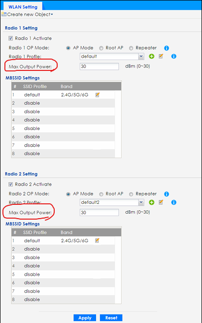

- Adjust Transmit Power: Lower the 2.4 GHz transmit power or set the 5 GHz transmit power at least 5 dBm higher. This helps dual-band clients prefer the 5 GHz signal when both are available.
- Navigate to Configuration > Wireless > AP Management to set the desired max output power for Radio 1 (2.4 GHz) or Radio 2 (5 GHz)

What I 've learned is to adapt the transmit power, 30dBm is a lot, that's on purpose as it is oriented toward entreprise.
After a long time scratching my head, I share what's working for a seamless transition between Wifi bands (6/5/2.4Ghz, and LTE on mobile Phone):
- 29 dBm for 6Ghz
- 27 dBm for 5Ghz
- 25 dBm for 2.4Ghz
That way laptops or mobile phones use several other parameters (signal quality, noise ratio, …)than power to optimize the connection. The connection is then far more reliable than keeping 30dBm for all three 6/5/2.4Ghz radios, which is the setting by default.
I suggest this could be the default setting for future firmware also, since it is not that natural, even from some advanced customer point of view (a little "less is more" is suitable in that case).
If you keep 30dBm accross all radios, symptoms are phones try to stay on higher bands because the signal power is great, but connection stalls, because signal quality is not usable. If you have several APs, phone try to stay on NWA130BE AP, because of the strong power signal, but signal quality is subpar, and this prevents the phone choosing the correct AP (weaker power, but better signal quality), or even LTE.
