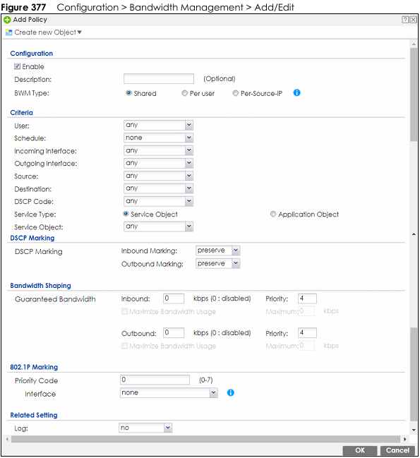

If the CPU usage is confirmed to be high, you may try the following temporary workaround: configuring Bandwidth Management (BWM) on the firewall to limit VPN traffic and prevent the device from running at full load.
- Go to Configuration > Bandwidth Management > Add/Edit → Enable it, then add a rule to limit the bandwidth for VPN traffic
