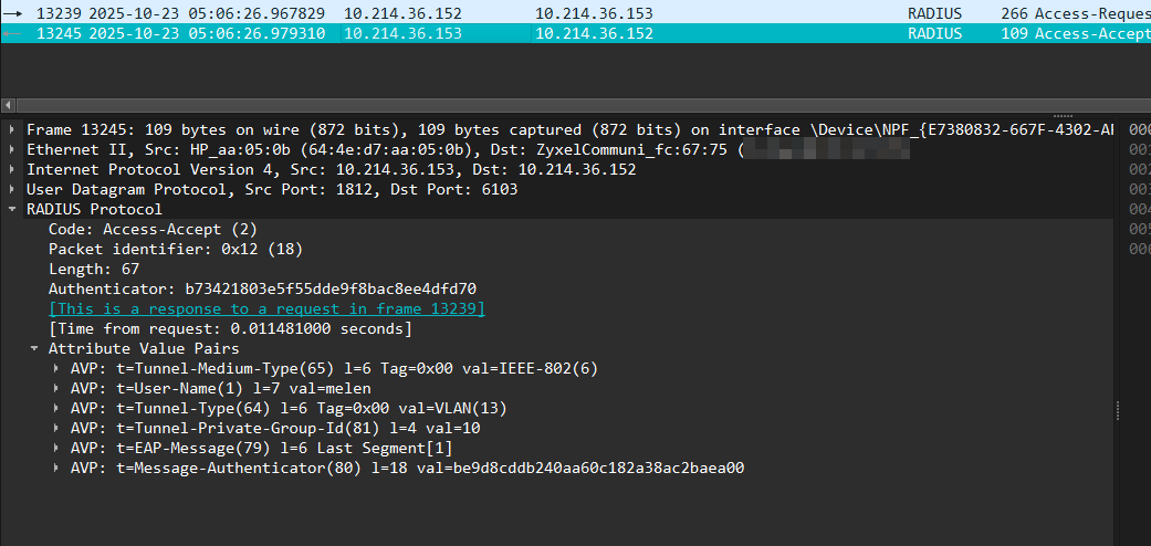

Can I send you a pcap?0 -
Hi @Mutko
Yes, please send the pcap, GS1900's tech support file, and the attribute you set on Cisco Radius.
Zyxel Melen0
