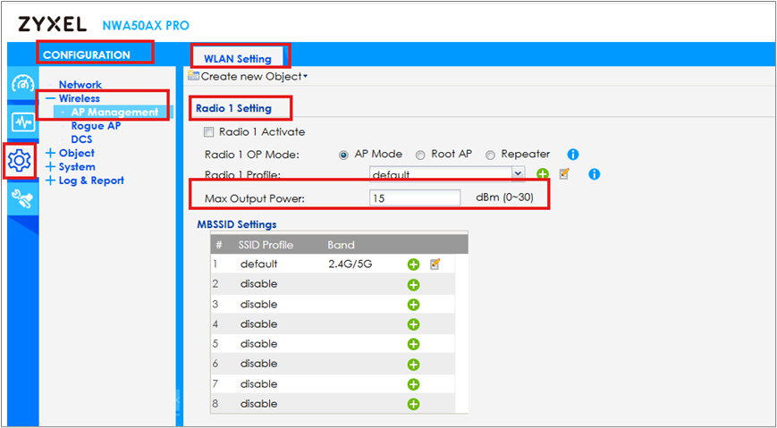

    1. Reduce the Output Power of the 2.4 GHz Radio
    To lower the transmission power of the 2.4 GHz radio:
    Navigate to Configuration > Wireless > AP Management > WLAN Setting > Radio 1 Setting
    Manually adjust Radio 1's maximum output power (for example, from 30 dBm to 15 dBm)
    Please note that the AP GUI currently does not support automatic power scheduling. You will need to manually adjust the output power each time you want to change it, as there is no scheduled power adjustment feature available in the interface.

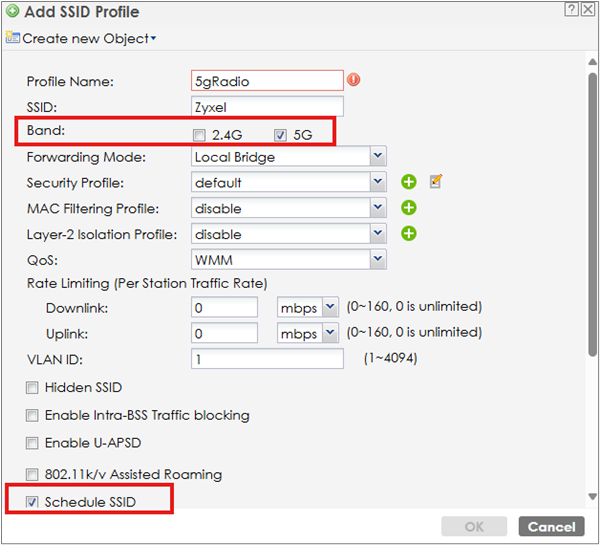

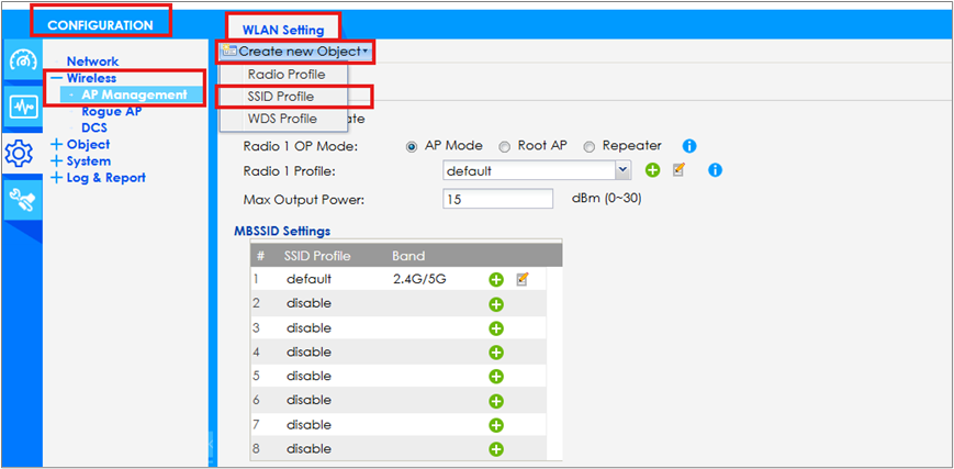

    Navigate to Configuration > Wireless > AP Management > WLAN Setting > Create New Object > SSID Profile
    In the configuration window that appears:
    Select 5 GHz as the band

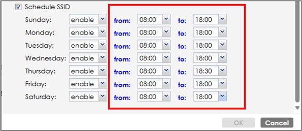

    Enable the Schedule SSID option
    Set your desired time schedule (for example, Monday to Saturday 8:00–17:00)
    With this configuration, the SSID will only broadcast during the scheduled hours. Outside of this time period, the 5 GHz radio will be disabled.

    1) I don't have a "Configuration > Wireless > AP Management > WLAN Setting > Create New Object > SSID Profile" entry. I only have Radio Profile and WDS Profile.
    I can make a new Profile in "Object > AP Profile > SSID" where I could set up a scheduled profile for 5G but this would have a different SSID as the 2.4G and so it's not useful. Therefore I can't see a way to turn on or off one frequency for the same SSID and leave the other on.
