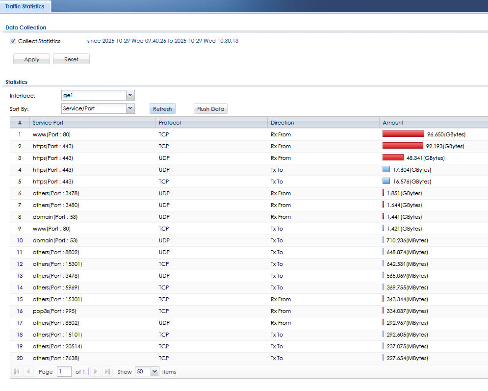

    I don't see traffic on 445 port. What do you think about?

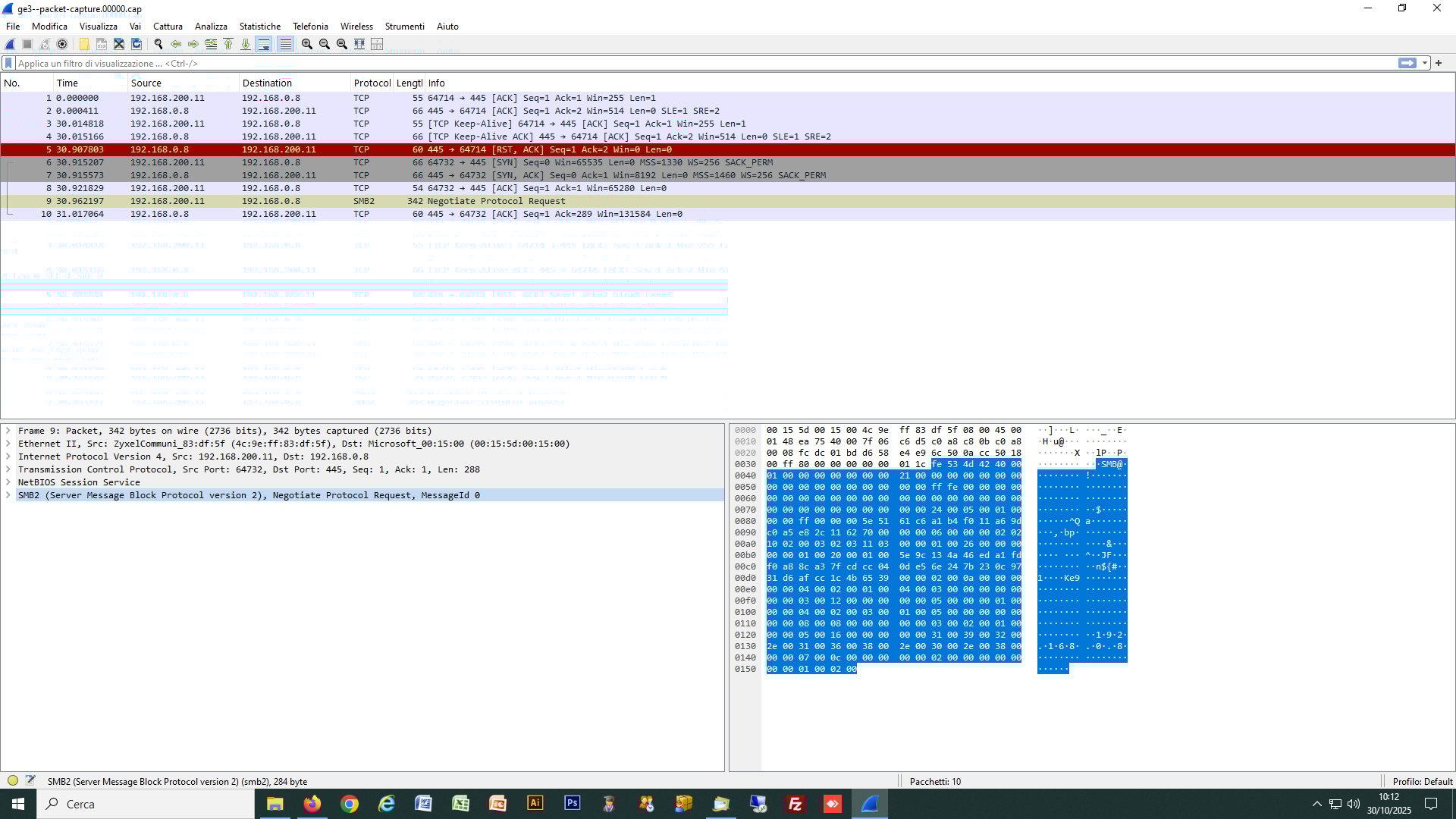

    Thats Statistics go to maintenance > diagnostics > packet capture tab move the interface your server in on to be captured put in host port 445 and click capture.
    On the remote PC do \\192.168.x.x for your server IP then stop capture go to file tab and view the .cap file and look for the SSL remote IP.
    also is remote PC before SSL VPN connects not on 192.168.0.0/24 by DHCP?

    So there is two connection with there being SYN, SYN ACK and ACK so like the server is not allowing access to the file share.
    is the client and server on the same workgroup name?
    If needed you could run a FTP server instead
