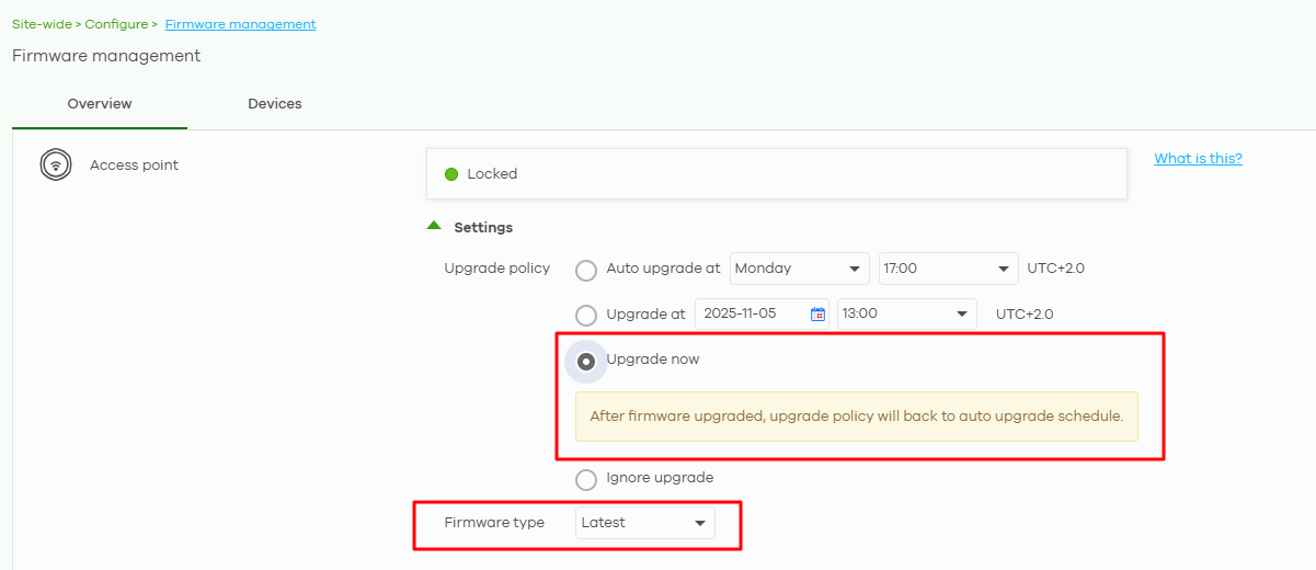

To upgrade your NWA50AX PRO to the latest firmware, please navigate to Menu > Site-wide > configure > firmware management to select the latest firmware for your AP and select upgrade now to upgrade.

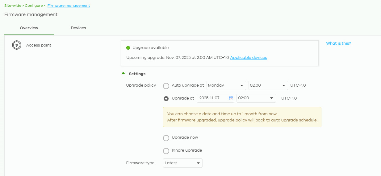

Hi @Riot_Jay
Let me help to set the firmware type to latest and upgrade at Nov. 07, 2025 2:00AM for Bureau de France.
By the way, I noticed Sherwood office AP has update to the latest firmware, but it still occurring the 10M/100M uplink issue. This is more likely the physical layer issue. Please try to:
- Check the link speed setting on the uplink switch. (If it is management switch) Please ensure the link speed is set to auto or 1000M/1G.
- Change switch port.
- Change cable.
- Change a switch.
Hope this helps.
