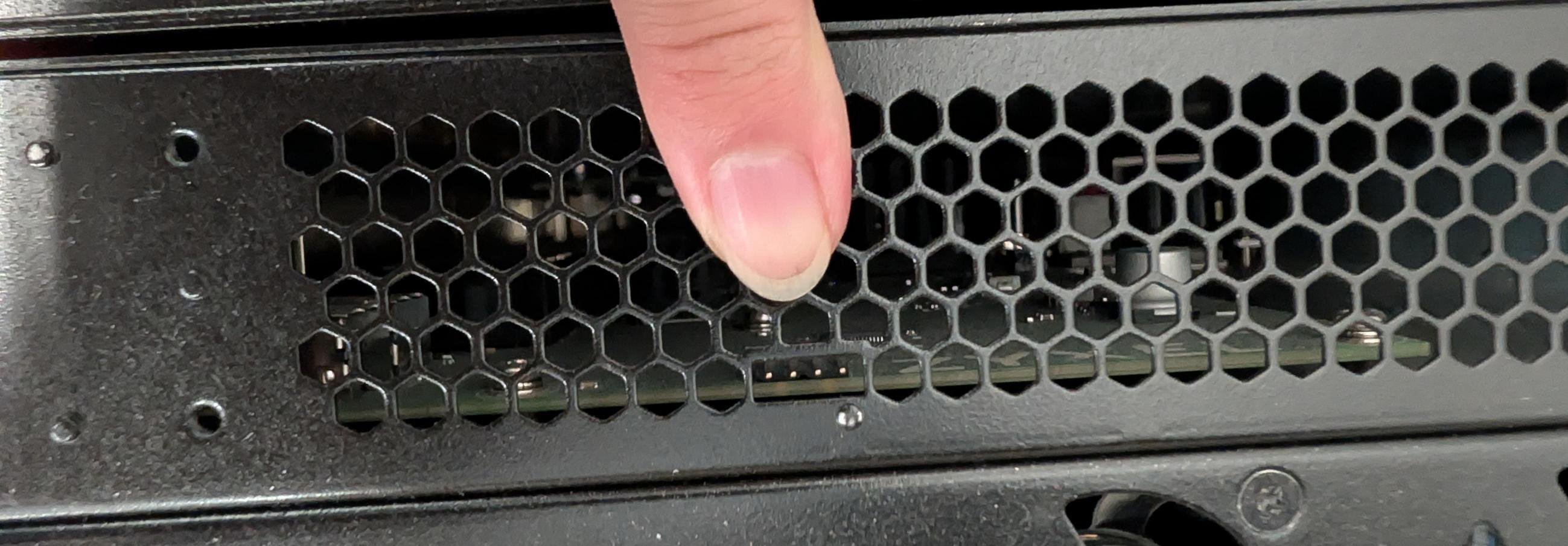

    May I know the status of the SYS LED? If it is blinking, could you help find a 4-pin console to get the booting message? Here is the location of the 4-pin console.
    And here is the info of how to connect the 4-pin console:
    How to use the 4 pin console to connect to Zyxel switch? — Zyxel Community
    Thanks.

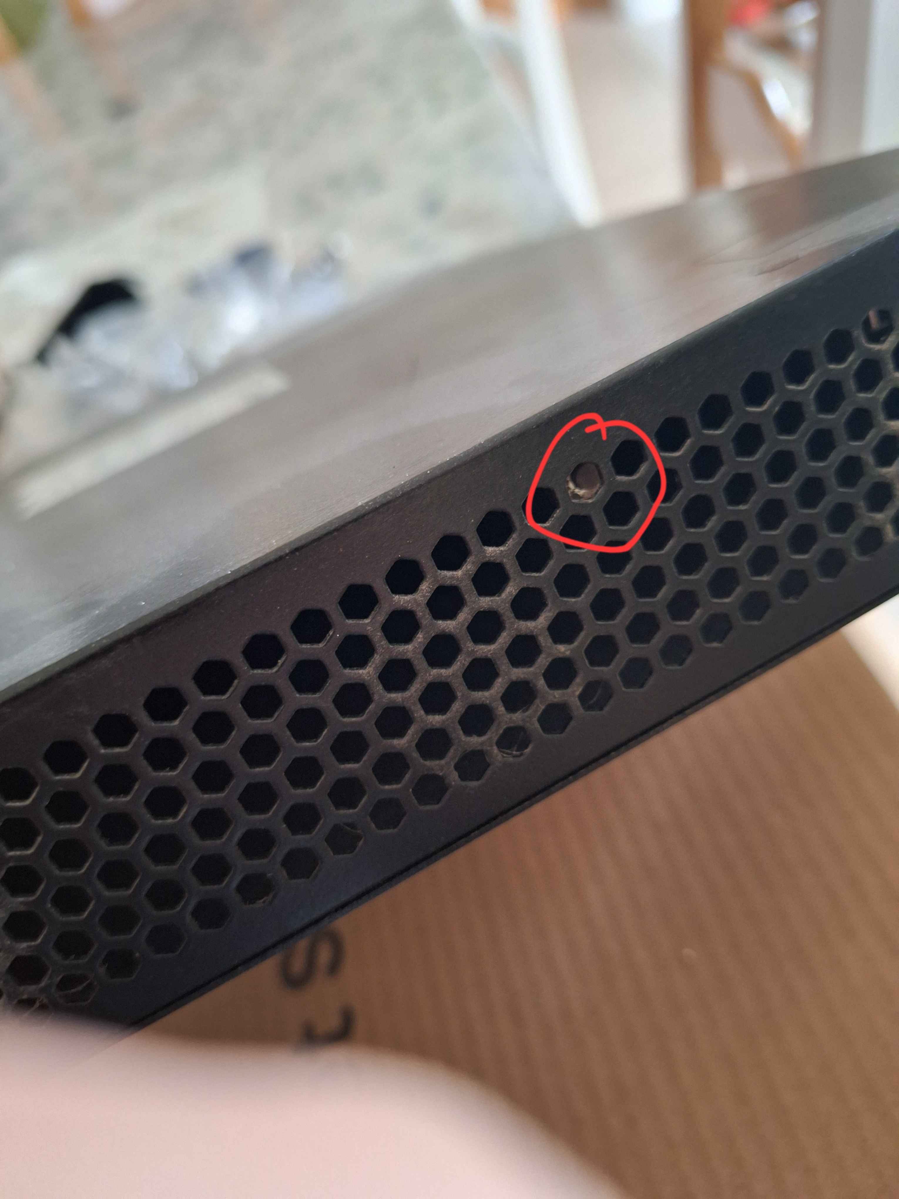

    I just want to point out that the switch (the one I had issues with) don't have the console port you mentionned, I just found a button on one side but I don't know what it does.
    Regards,
