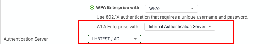

- SSID is setup for WPA2(3)-Enterprise set as "WPA Enterprise with = Internal Authentication server" and "Authentication server = AD configured above".
When I try to login on SSID and put known credentials it doesn't work. I checked FW and there are no rules trigger/no traffic is observed on AD interface. Logs says almost nothing:
AP log: User test (MAC: <OUI>) 802.1X auth failed on interface wlan-2-2.(Server: 10.50.200.1:1812)
Debug level: kernel [193934.502729] Can't find user (mac-users) profile in KUser_head
Not sure if debug log is related, but it is generated at the time I try to authenticate and reading message and observing no traffic to AD server it looks like the entire config doesn't work.
