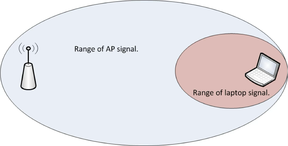

Wi-Fi is a two-way conversation
Even if the AP transmits at high power, your client devices (smartphones, tablets, IoT) do not.
A phone or a laptop transmits at a fraction of the AP’s power.
This results in the classic phenomenon:
The client “hears” the AP, but the AP does not “hear” the client.
This leads to dropped packets, reduced throughput, sticky clients unable to roam and surprisingly poor performance far before “signal bars” drop to zero
