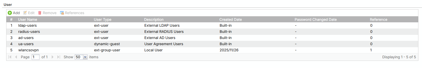

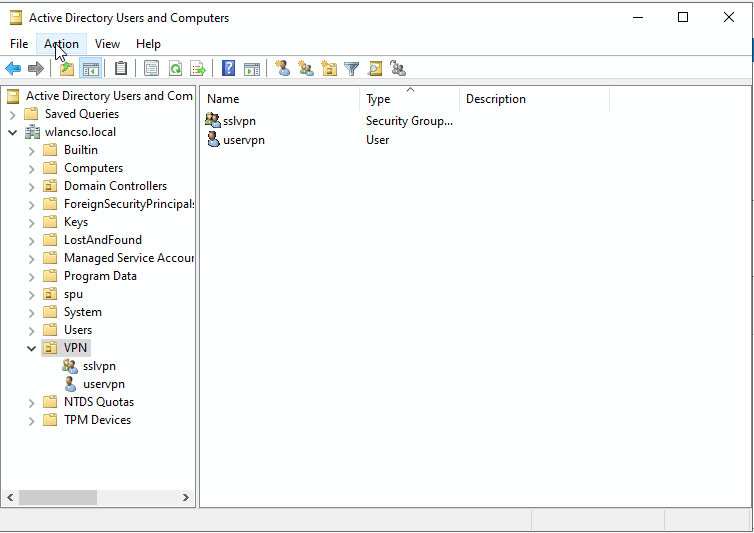

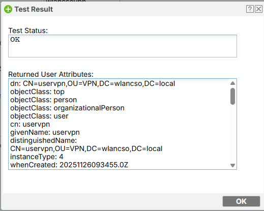

    Let me share my test user and ext-group-user setting with you. I can use this setting to login SSL VPN.
    Check the AD user, if it is in this user group, the test status will display "OK".
    If not, it will display this user does not belong to this group.
    My User list.

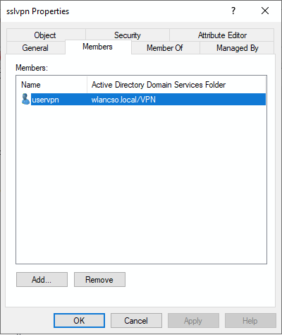

    AD user setting:

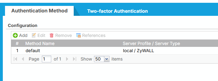

    Hi @RPasha
    May I know if you have added the AD server to the authentication method?
    From the config you post, I can't find related config. Please help to check this first. If you haven't, please add it first.

    Hi, Zyxel_Melen
    I have:
    Was:
    aaa authentication AD group dc01
    add
    aaa authentication authSSLvpn group dc01 local
    But I couldn't find it for use anywhere in the SSL VPN settings (not SSL portal).

    AD user setting:
