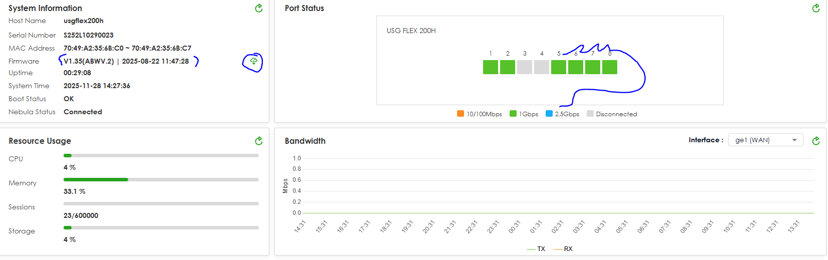

    VID defaults to Lan1 and works mostly. Any other vLans fail to be routed from the XMG1915-10E (plus it keeps changing settings like the Nebula is running in the background even when all Nebula is turned off along with the routes to it)..
    I tried manual tag port / VID assignment and all that works is Lan1. Found vLan devices stealing IPs from Lan1 even though static routing & DHCP reserved MAC is enabled in both FW & SW respectively.
    I had to purchase 2 WBE530 because the Flex 200h fails to find the old APs that the Flex 500 was happy to manager - all this just to carry 3 vLans and Lan1 - nothing seems to work except Lan1.

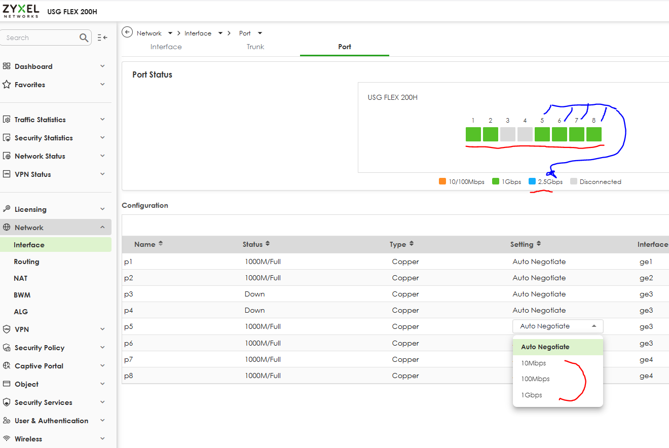

    Tried to change from vLans to LAN2 - same issue, interestingly, the Flex 200h dropped the second default Ge4 interface, Port 5 went dark, and then the Flex 200H has stopped supporting 2.5Gb and only allows 10m, 100m, 1g on ALL Ports. -

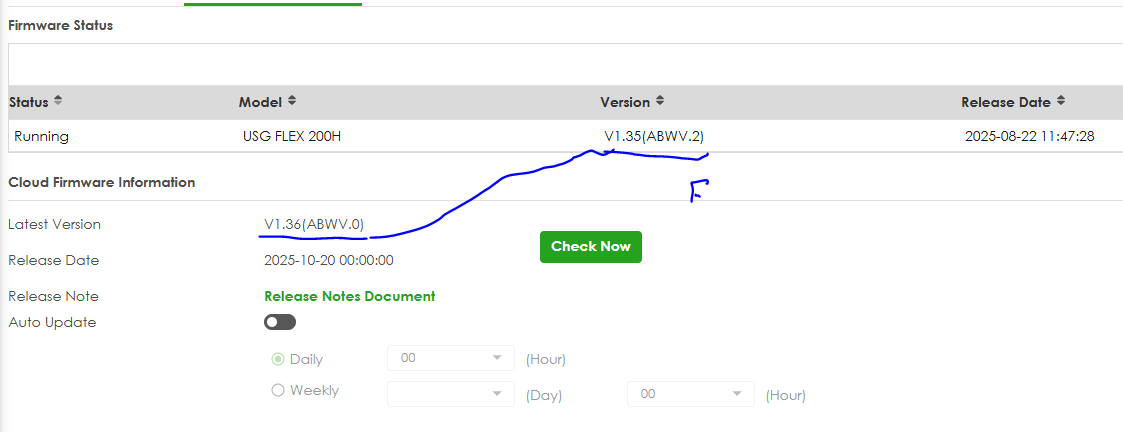

    • Rolled back to previous Firmware
    • Update again to current

    Nothing works to restore to 2.5Gb between the switches & firewall, the primary reason I replaced my older 1Gb USG FLEX500, GS1900-24HP & WAC6502D-s network. Port 5 on the Flex 200h is the link to the XMG1915 with 6 & 7 to the other ZyXel XMG-108 & 105 2.5Gb switches respectively.

    The USG FLEX 200H supports 2.5G only on ports 1 and 2. Melen also mentioned this in another post from you:
