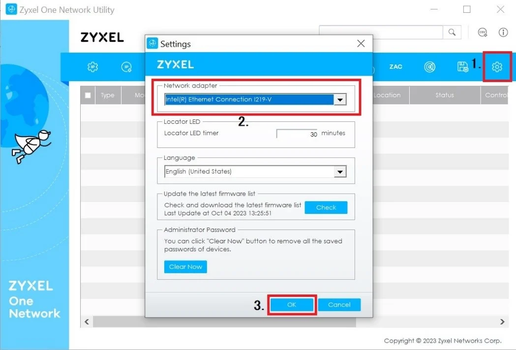

- Step 3. Select the “Settings” icon on the right side of the bar
And choose the network interface card which you’re using connect to your network.

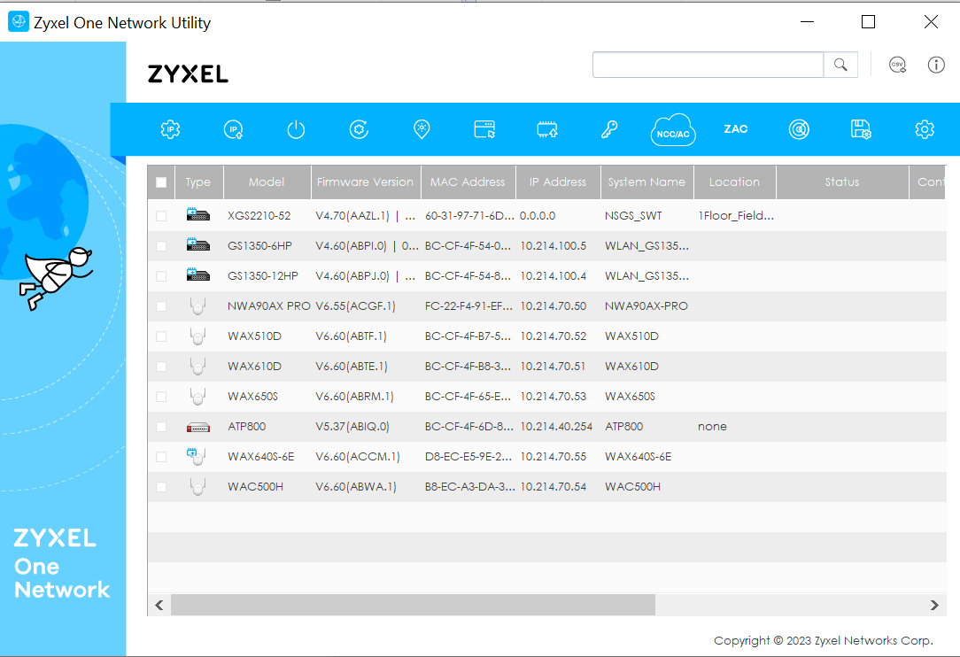

Step 4. Click the “Clear and rescan” button
Wait until the scan process is complete, you’ll be able to see your AP is listed in the table.
*Please ensure the laptop running ZON tool is connect to the same network with correct network interface card selected in settings to scan (Step 4.)
Step 5. Select the AP which plan to upgrade the provided firmware, then click the “Firmware Upgrade” icon.

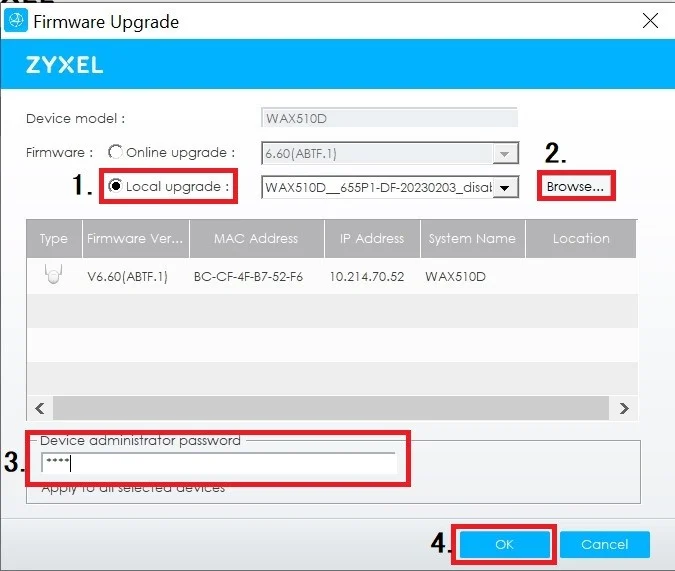

Step 6. Select the “Local upgrade” option and click “Browse…” to upload the provided firmware. (.bin file), and fill in the password, then press “OK” button to proceed the upgrade.

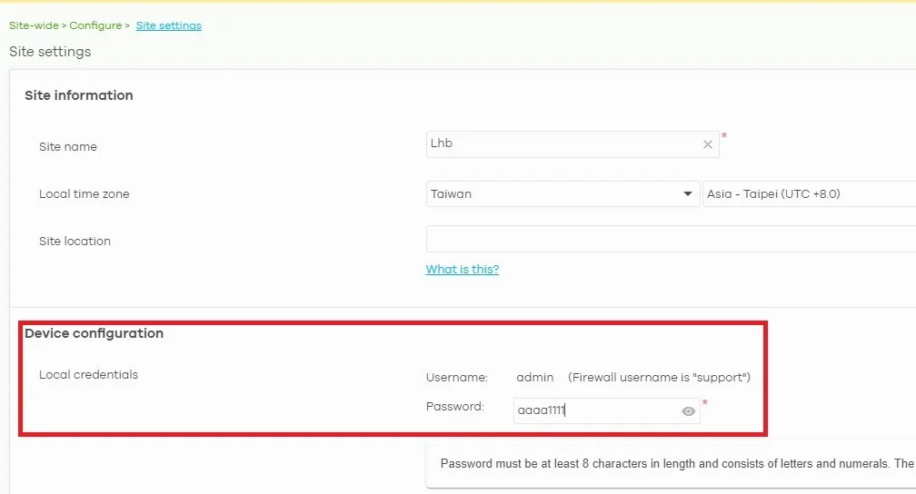

*Note: The device is being managed on Nebula, please go to Nebula web site, navigate to Nebula > Configure > Site setting > Device configuration to check your password
