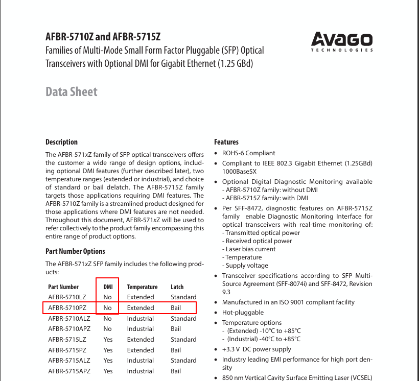

Any idea why?

    Copper transceiver normally not support ddmi info. But the fiber transceiver doesn't support DDMI could be because the vendor doesn't provide the ddmi info to the switch.

    Seems like AVAGO AFBR-5710PZ doesn't support DDMI.
