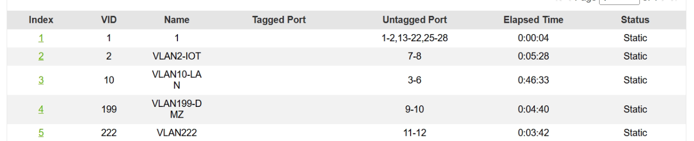

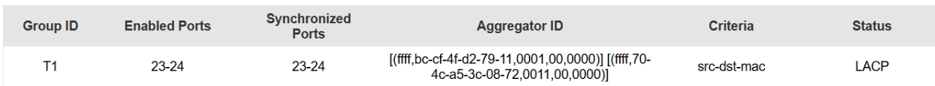

A portchannel (2 ports) on my Fortigate containing 4 VLANs (VLAN2, 10, 199, 222) should be connected to a portchannel on my Zyxel-Switch and on the switch i would need to have some ports in each of the vlans. Subnet/VLAN-definition and DHCP is done on my fortigate.

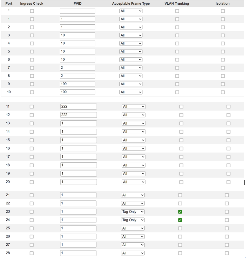

I have created the LACP on firewall and on switch. On the switch the ports for the LACP are set to trunking, VLAN1 is forbidden on trunk-ports as well as on the ports which should belong to the VLANs. PVID is set on the ports corresponding to VLAN-ID.

According to CLI on Fortigate LACP-Portchannel is working and on switch it is showing active.
the vlans
VLAN-Port-Setup

VLAN trunking is enabled on switch ports 23 and 24. However, enabling this feature only allows the switch to forward unknown VLAN traffic. You have created VLANs 2, 10, 199, and 222, so these are known VLANs, not unknown VLANs.
The easiest solution is to tag ports 23 and 24 for all of your VLANs except VLAN 1.
