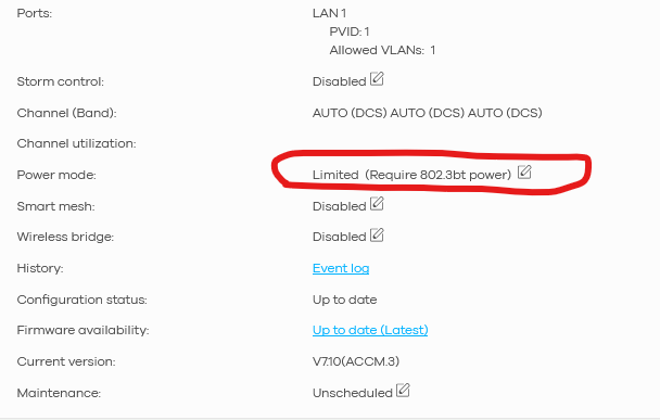

Hello everyone,
following this post:
I used a PoE+ switch (non Zyxel) to have this AP online:
But Nebula is telling me that it needs PoE++:

    After discussion, the "Limit mode" you saw earlier with the non-Zyxel switch was likely due to conservative or incomplete PoE capability reporting/LLDP negotiation from the third-party device. This caused the AP to default to 802.3af (PoE) standards, restricting power delivery.
    In addition, switching to the Zyxel GS1915-8EP properly negotiates 802.3at (PoE+), delivering full power as shown in the NCC "Full (Power by PoE)". This is the expected behavior and matches the AP's datasheet specs for unrestricted operation. Therefore, no WiFi functionalities or antennas will be disabled.

    After checking, we confirm that the WAX640S-6E AP requires PoE++ (802.3bt) power. Therefore, the "Limited (Require 802.3bt power)" warning in Nebula is expected behavior.
    Regarding the FAQ you mentioned, we've updated it to correctly include the WAX640S-6E as a PoE++-required model. We apologize for any confusion caused and thank you for pointing that out. 😉

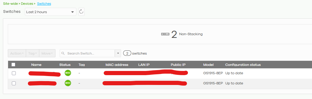

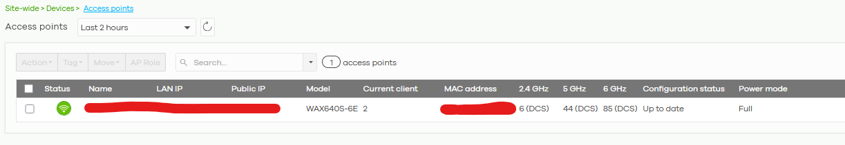

    I had some Zyxel PoE+ switches in my warehouse, so I decided to test the PoE power with this AP.
    I went onsite and linked this AP:
    To these switches:

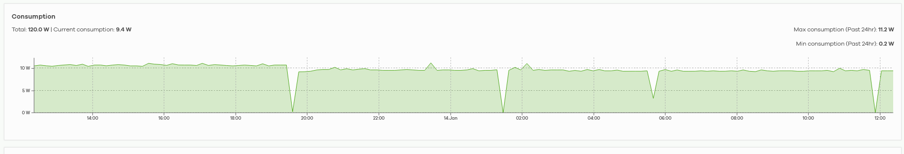

    I see a power draw of MAX 12W:

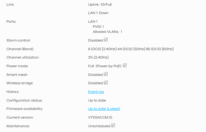

    Is it compatible with the AP's specs, considering that it shows Full power mode:
    OR I have to consider the risk of having some WiFi functionalities/antennas disabled?
