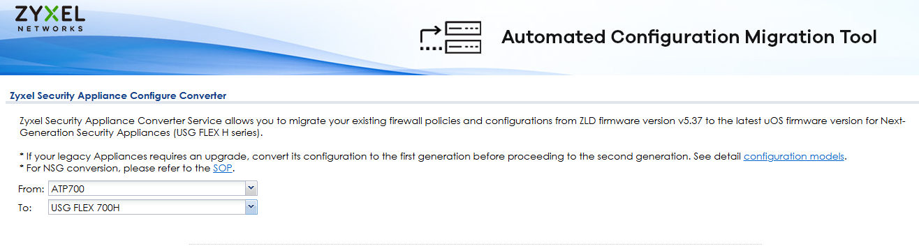

Hello, I performed a configuration migration from an ATP700 to a USG FLEX 700H.
After installing the USG FLEX 700H on the client and replacing the ATP700, the USG FLEX 700H is not working correctly.

- Review Configuration Converter Limitations: The Zyxel Security Appliance Configure Converter allows migration of existing firewall policies and configurations from ZLD firmware to the latest uOS firmware for USG FLEX H series. However, not all features map 1:1, and some settings might be adjusted, restructured, or removed. It's crucial to review the detailed log file from the conversion to check what was successfully migrated and if any features are not supported on the USG FLEX 700H.
