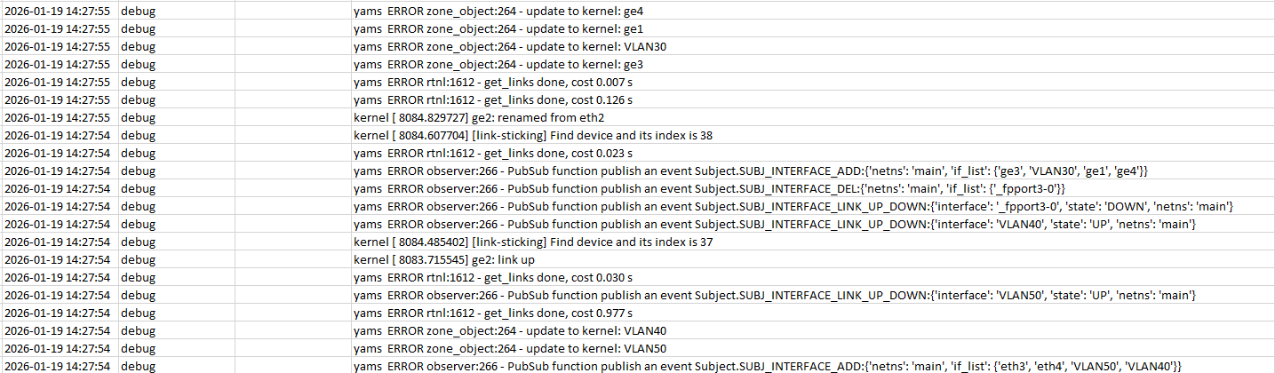

The firewall stops (without restarting) and becomes inaccessible via WANs and LANs for a few minutes before starting to work again.
There are also multiple errors in the debug log. What can I do?

    Hi Tina, since I was having problems, I did a complete programming run without loading the ATP700 backup.
    I couldn't wait for the change.
    The USG700H is at the client's site and the same problem persists even though the programming hasn't been migrated.
    WAN and LAN access is lost, even though the USG700H doesn't restart, but LAN-WAN access is lost for a few minutes.
    We need a quick solution to this problem. Log attached.
    It seems the zone kernel has an error and is becoming inaccessible.
