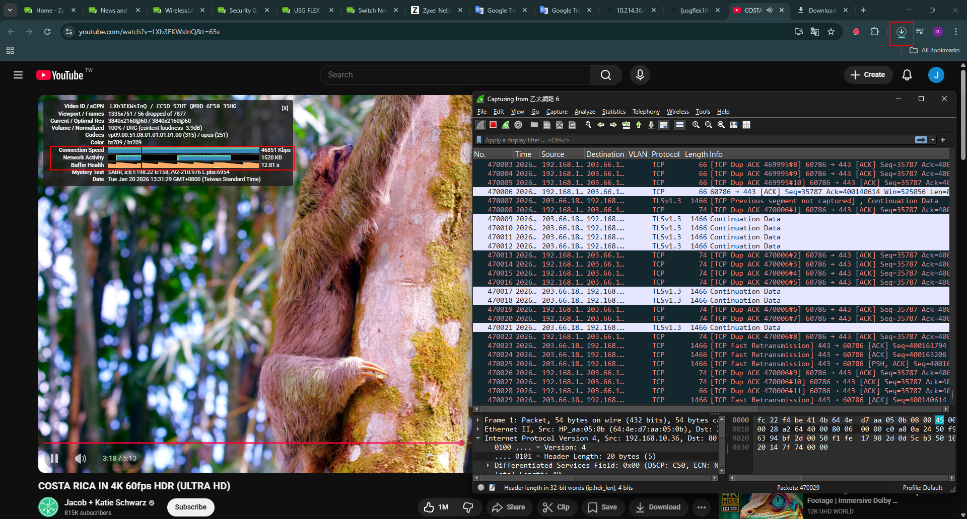

Back to this problem when you set a Egress limit on a interface say 50Mb when a device is connected to that interface it should limit to 50Mb download and it does with or without BWM good so far. As a test youtube can use UDP or TCP which to test TCP you block UDP port 443 to make youtube use TCP and this is the a 4K Video
https://www.youtube.com/watch?v=LXb3EKWsInQ&t=65s
the test is to make the Video buffer which sounds wrong but is correct due to limited bandwidth you set being 50Mb. Which firewall blocking UDP 443 you run the above Video all is fine then you want to test load with a download like this test file
http://ipv4.download.thinkbroadband.com/1GB.zip
with a download manager to add threads as bandwidth is divided at which point the Video will buffer and for TCP it does.

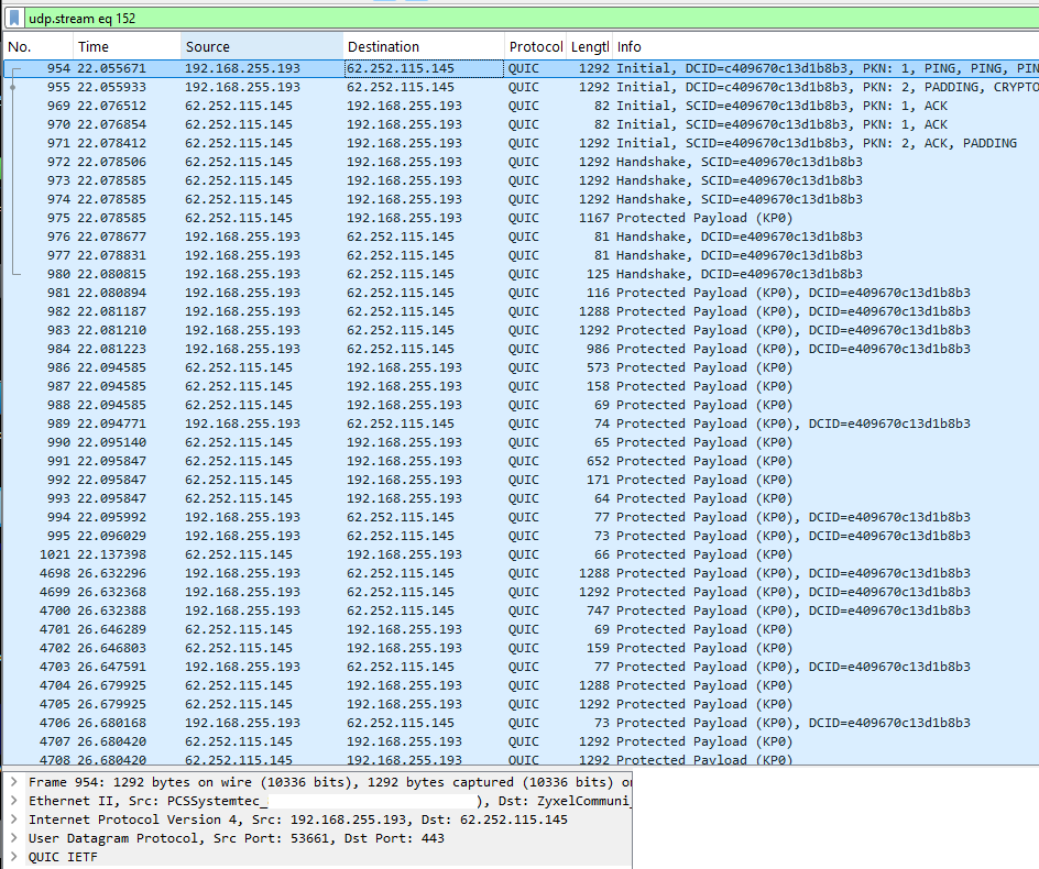

So now allow UDP 443 and run the above Video (check by Wireshark) and do the same test and the Video does not buffer this is wrong with the added download file and number of threads it didn’t buffer and it should.

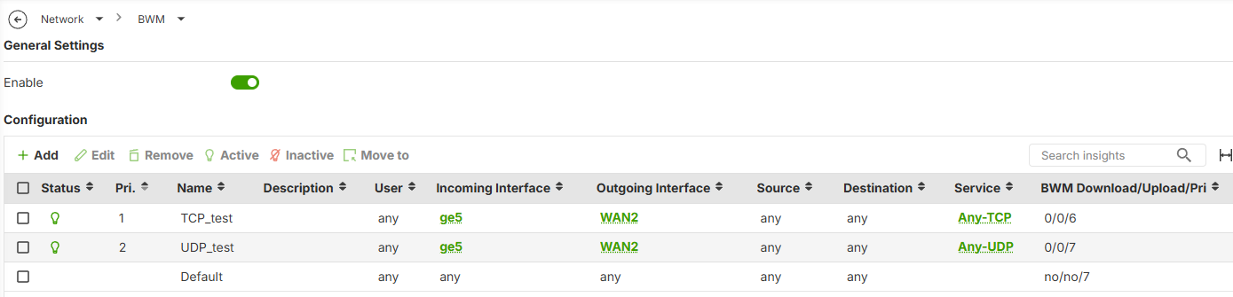

I then did this in BWM where I made any TCP Priority 6 and any UDP Priority 7 it still didn't buffer the Video and it should meaning BWM rules are being ignored.

      • Confirm that the BWM rules you've created (TCP_test and UDP_test) are active and correctly ordered. Rules are processed from top to bottom, and the first matching rule is applied.
      • Double-check that the Incoming Interface (ge5) and Outgoing Interface (WAN2) specified in your BWM rules accurately reflect your network topology and the traffic path you intend to manage.
      • For the "BWM Download/Upload/Pri" column, ensure that the priority values (6 for TCP, 7 for UDP) are correctly entered and that these priorities are within the valid range for your device. A lower number generally indicates higher priority.

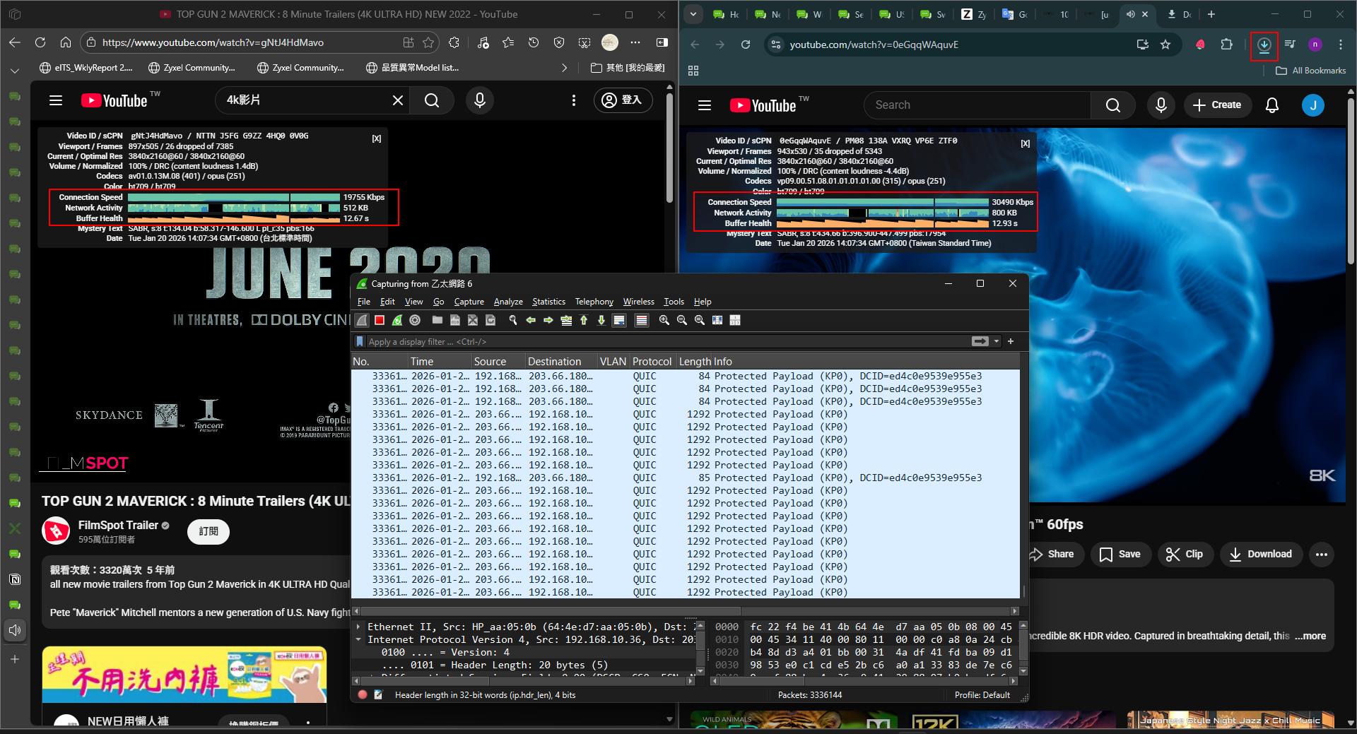

    You need to test YouTube by UDP QUIC
    What I'm trying to cause is limited bandwidth test when run with a TCP download to buffer the Video buffer as in not enough bandwidth for the Video to buffer

    Hi Peter,
    I also test with UDP after allow UDP, like this. It seems like is still buffering. Could you help point out what I might miss, so we can better replication this issue in our lab?
    Please also help to record a video so we can better verify this issue.
    Zyxel Melen
