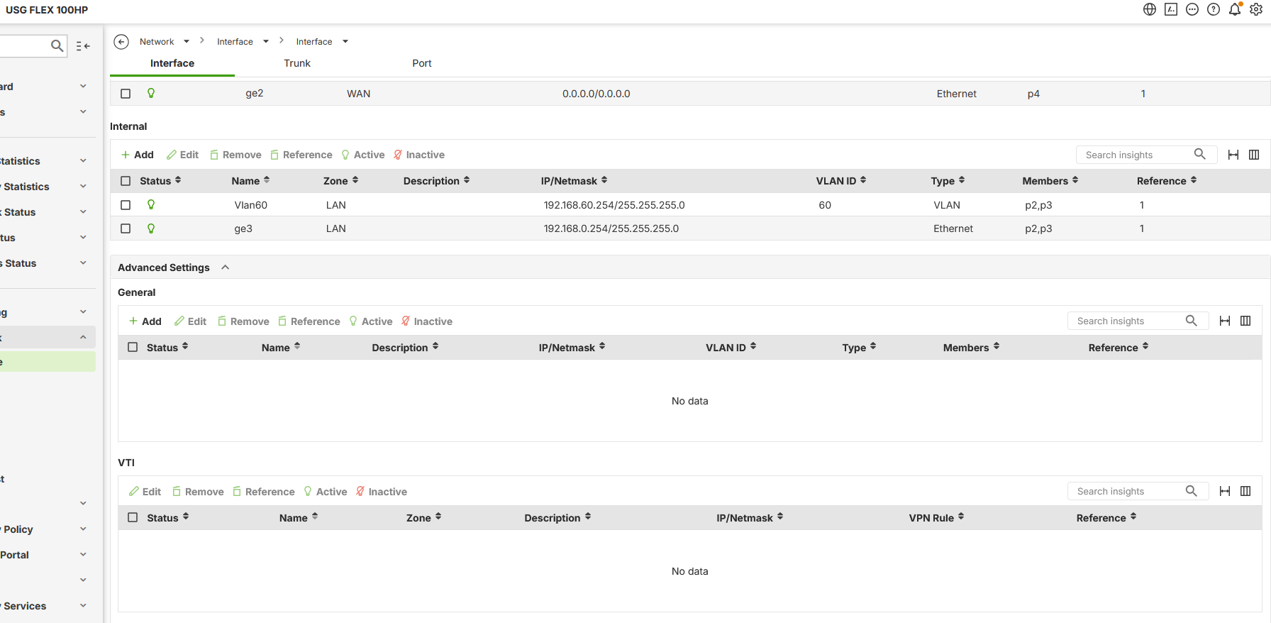

I moved a firewall from a test site to a production site, I updated it to 1.37
So I went to check its DNS rule and I see:
This is the default internal subnet, while the firewall has different LANs:
Why Nebula still thinks that the firewall is reachable on 192.168.168.1 ?

It can be changed it is not auto linked to update its just a normal entry.

Hi @GiuseppeR
I checked on local GUI, the A record also does not auto update when changing Lan1/ge3 interface IP. I'm discussing with our team, and I will update you once I got further info.
