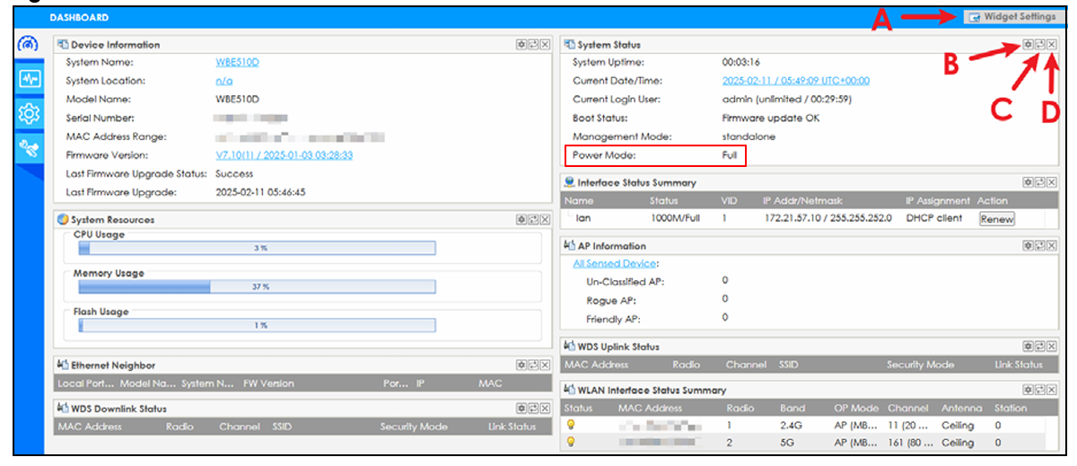

    About the low-power problem, the NWA210AX running in AF mode will decrease the available antenna.
    1. 2.4G antenna: 2 > 1.
    2. 5G antenna: 4 > 2.
    However, the PoE 12-30W should provide AT mode power to NWA210AX. Please check the dashbroad > System Status > Power Mode to check. Here only has two option: Full/Limited. If it is limited, please check the power first.

    Thanks much for your suggestions. The System Status > Power mode shows "Full".
