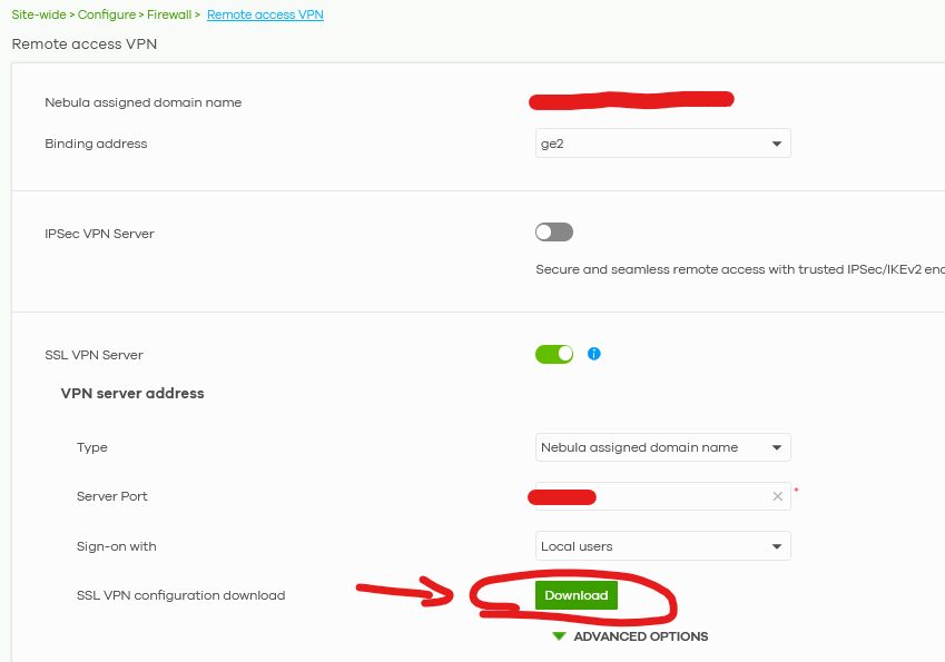

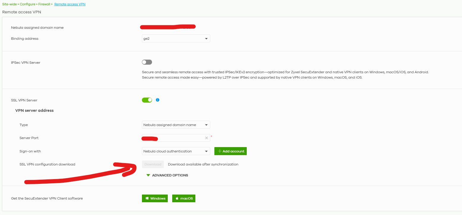

I saw that upgrading from 1.36 to 1.37 the Nebula UI shows me changed authentication from "Nebula cloud authenticaton" to "Local Users".
I re-use same screenshots taken for the above thread so do NOT look at the arrows but the "Sign-on with"…
—> 1.36 online config
—> 1.37 online config
Does that happen only to my setup?
Anyone else sees the same changing?

Did you perhaps have Local users selected on the local USG GUI prior to the firmware update, and after the firmware update reboot, this local config has synchronised to Nebula?
The download option being grey in the first photo would indicate that the USG had a 'Not up to date' configuration status on the Nebula side before updating to uOS 1.37.
