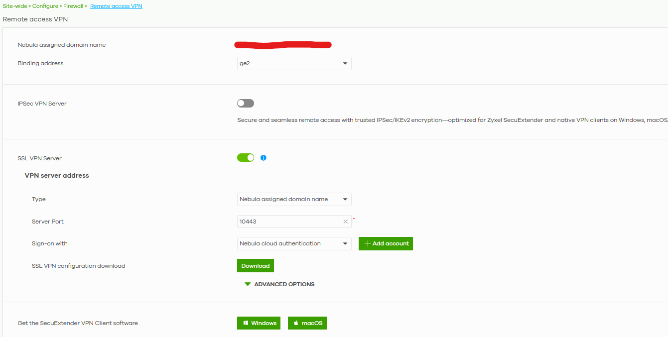

I setup a SSL VPN via Nebula, I see some issues. I'm using 10443 standard port.

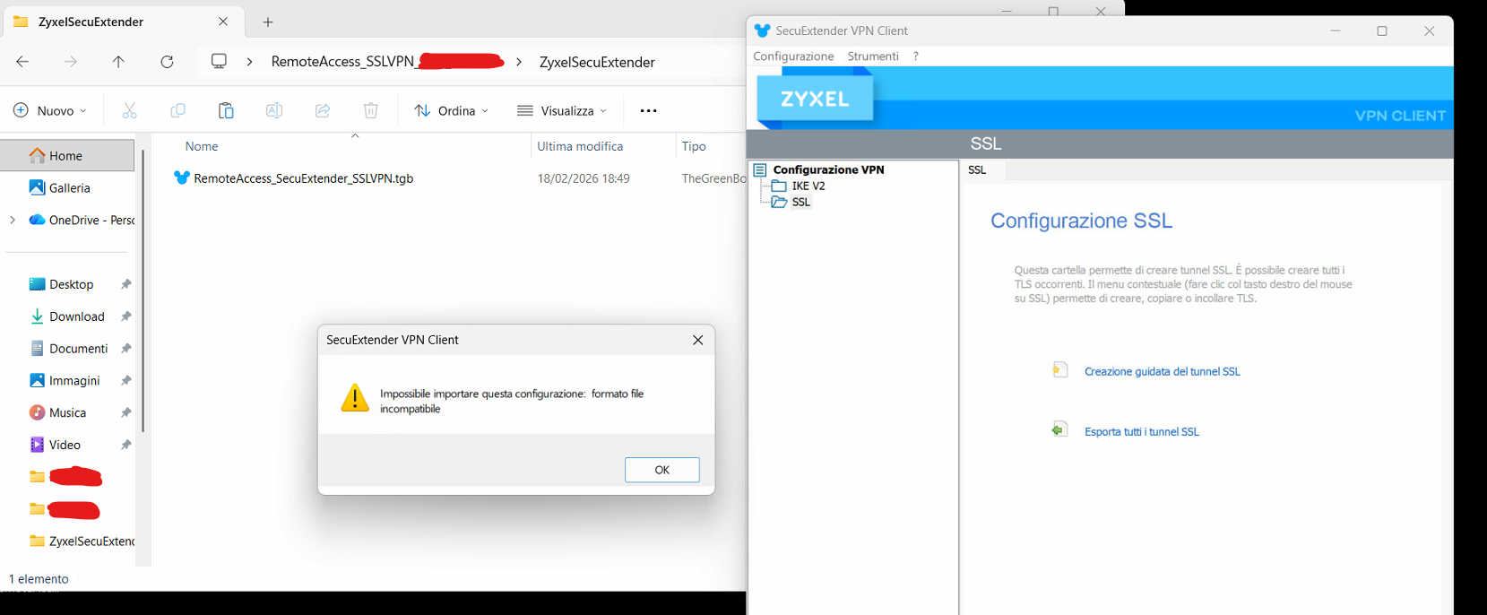

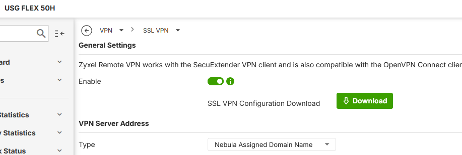

-1- I went here:

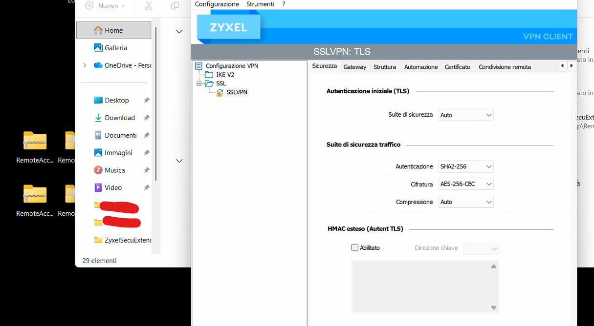

And clicking Download button I downloaded a Zip file where the tgb file is NOT accepted by the SecuExtender app:
The error shown is this one:

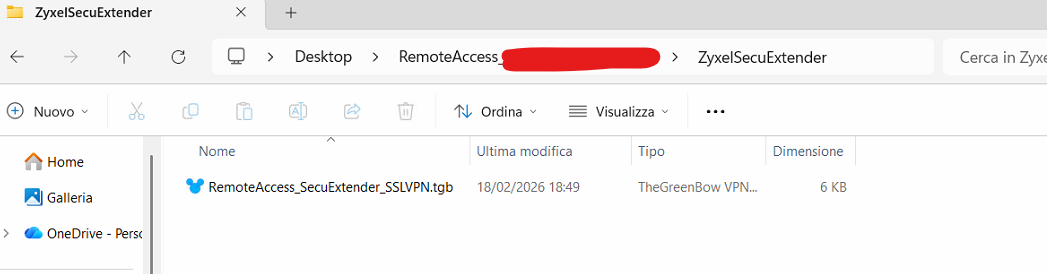

So I had to download that zip file via On-Premise interface:
And the file tgb is accepted only from here and I see my tunnel available:

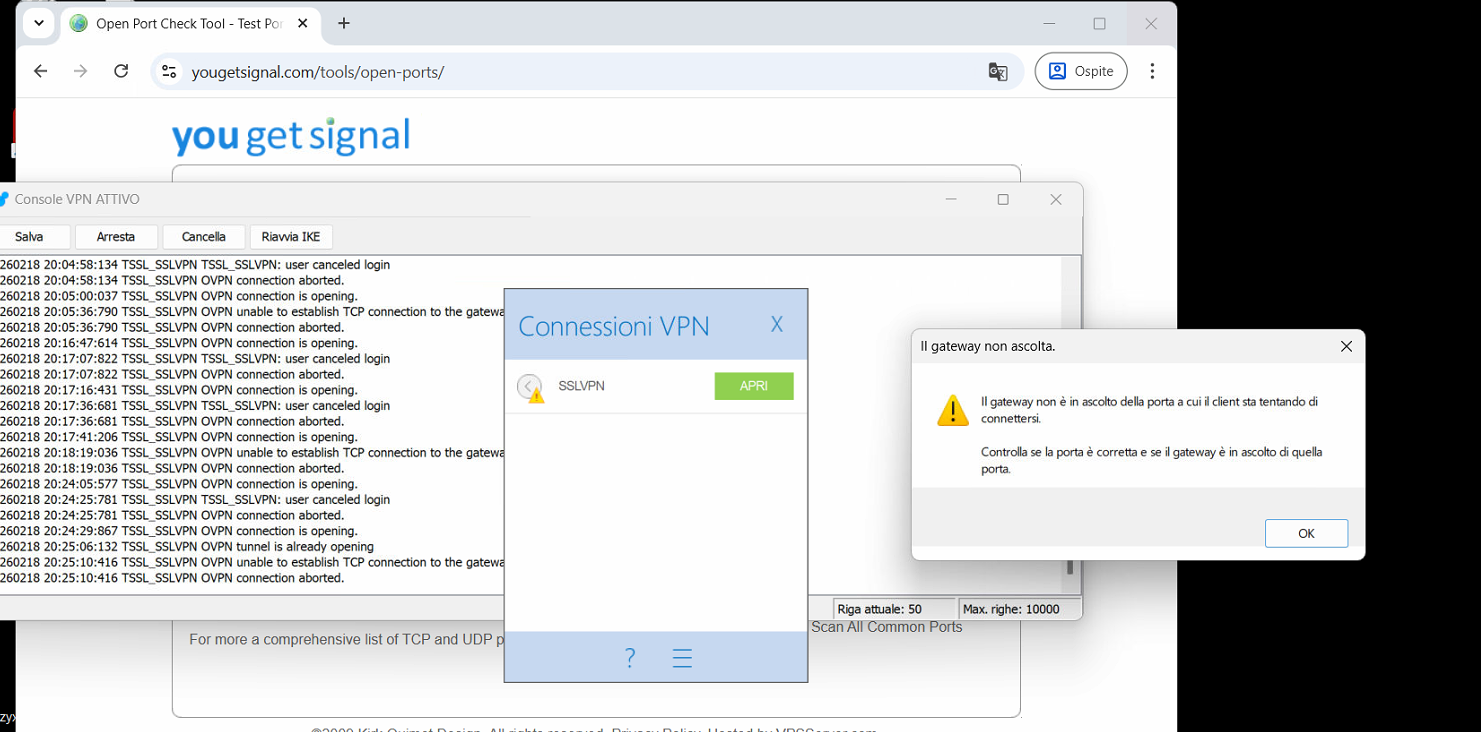

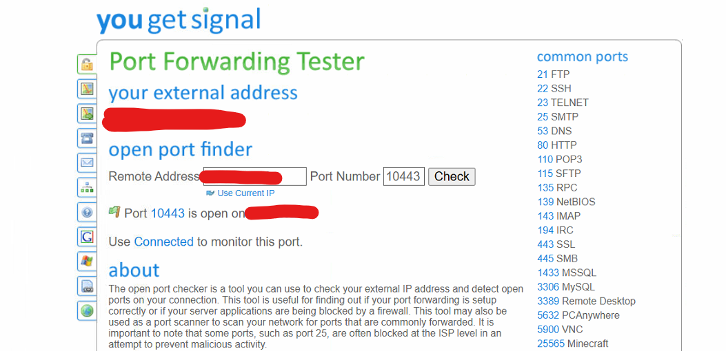

-2- Then I checked if that port was open:
Anyway I see this error:
It seems that the gateway does not respond properly.

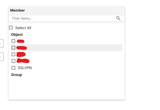

SSL VPN is also inside Service Group rule Default_Allow_WAN_To_ZyWall:
So I cannot see why with SSLVPN enabled and with open port the gateway does not respond to open the VPN tunnel.

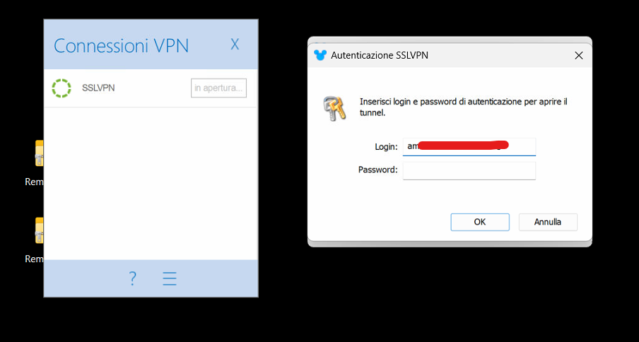

-3- When you use the panel to login, it has an infinite spinning wheel:
And it does not give feedback regarding the 2FA access that the specific Nebula User is using.
