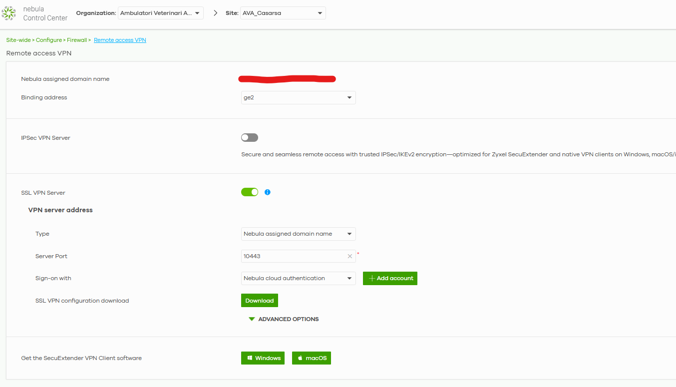

I setup a SSL VPN via Nebula, I see some issues. I'm using 10443 standard port.
-1- I went here:
And clicking Download button I downloaded a Zip file where the tgb file is NOT accepted by the SecuExtender app:
The error shown is this one:
So I had to download that zip file via On-Premise interface:
And the file tgb is accepted only from here and I see my tunnel available:

    Hi @GiuseppeR,
    Thank you for your patience throughout this investigation. Here's a summary of the findings and solutions:
    [Root Cause]
    The SecuExtender script had an extra blank line at the beginning of the TGB file, causing SSL VPN connection failures after upgrading the firewall to firmware 1.37(ACLO.0).
    [Resolution]
    The issue is now fixed, and the bugfix is included in the latest Nebula firmware (available since 3/10).
    We hope this helps anyone else encountering similar issues!
