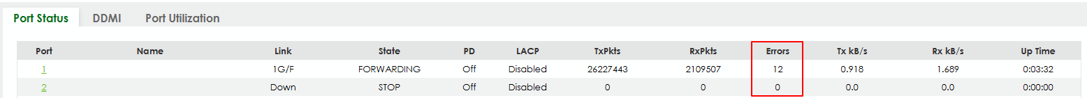

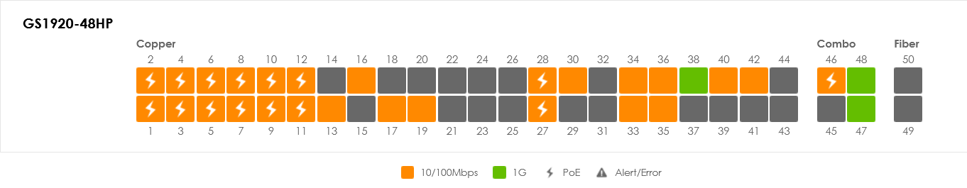

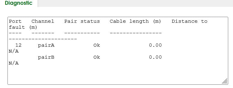

    Please help to share some information so we can better check this issue:
    1. Please help to check the port status of the issue ports to see if there has errors. Path: Menu > Monitor > Port status.
      image.png Also, please access the issue port's detail port status info page to check the details of the error. (Click the port number hyperlink) image.png
    2. Please help to share a list of the issue port. (Since there are many ports connects with PD.)

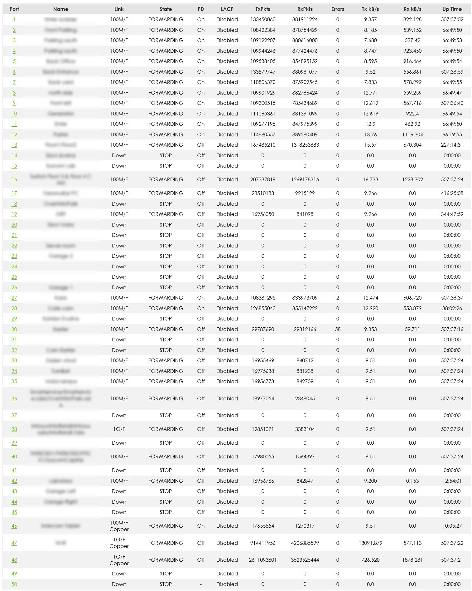

    The ports with PD - When I look at all the ports with PD, they drop out. Now I noticed that port 12 drops out, there are no errors..The cameras are Dahua
