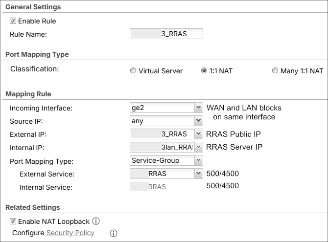

    Would you consider to share how 1:1 NAT in your ATP800 is configured?
    Feel free to hide any confidential detail.

    @mMontana I assume the following is what you are requesting.

    What you mean by WAN and LAN on the same interface?
    So it looks like I had it wrong about you setting up a Remote Access (Server Role) on the ATP800? and that really your look to have VPN traffic pass through the ATP800 to some other VPN server that a client wants to connect too?

    @PeterUK We have a fiber EDI which comes into an ONT they provided, which is connected to our ATP800. Even though the WAN and LAN blocks are separate (ie. not contiguous), because of that box they come in on the same interface. Really this is probably a distinction that did not need to be made, but I did so because of how mmontana phrased something.
    That is correct. I am not using anything VPN related in the ATP800. The connection is just passing through.
    I have not tested this without the ATP800 as we only have one ISP. Suppose I could try setting up a test internally with some other device. Just figured it was easier to confirm with Zyxel whether pass-through is possible or not. That I still don't know, nor about fragmentation.

    I'd consider to add these object to your service group:
    these images comes from a 5.42 firmware device, I'm not sure that they are available on your ATP800.
    Are you sure you need enabled "Nat Loopback"? Do you need to reach your IPSec server from other network segments?
    Last but not least: Windows Server has only one network adapter?

    @mMontana I'll try and look into another IPSec device. For the time being I added ESP and AH to the Service Group. They were already preconfigured by Zyxel in the Service list. I don't know that I really need "Nat Loopback" so I turned it off. Still not getting a connection and the Wireshark output is the same. Two IKE_SA_INIT entries followed by one IKE_AUTH, two Fragmented IP protocols, another IKE_AUTH, and then Destination unreachable. Thanks for the ESP suggestion. I was hoping that was the kicker but alas it was not. As for the server, yes it only has one network adapter.
