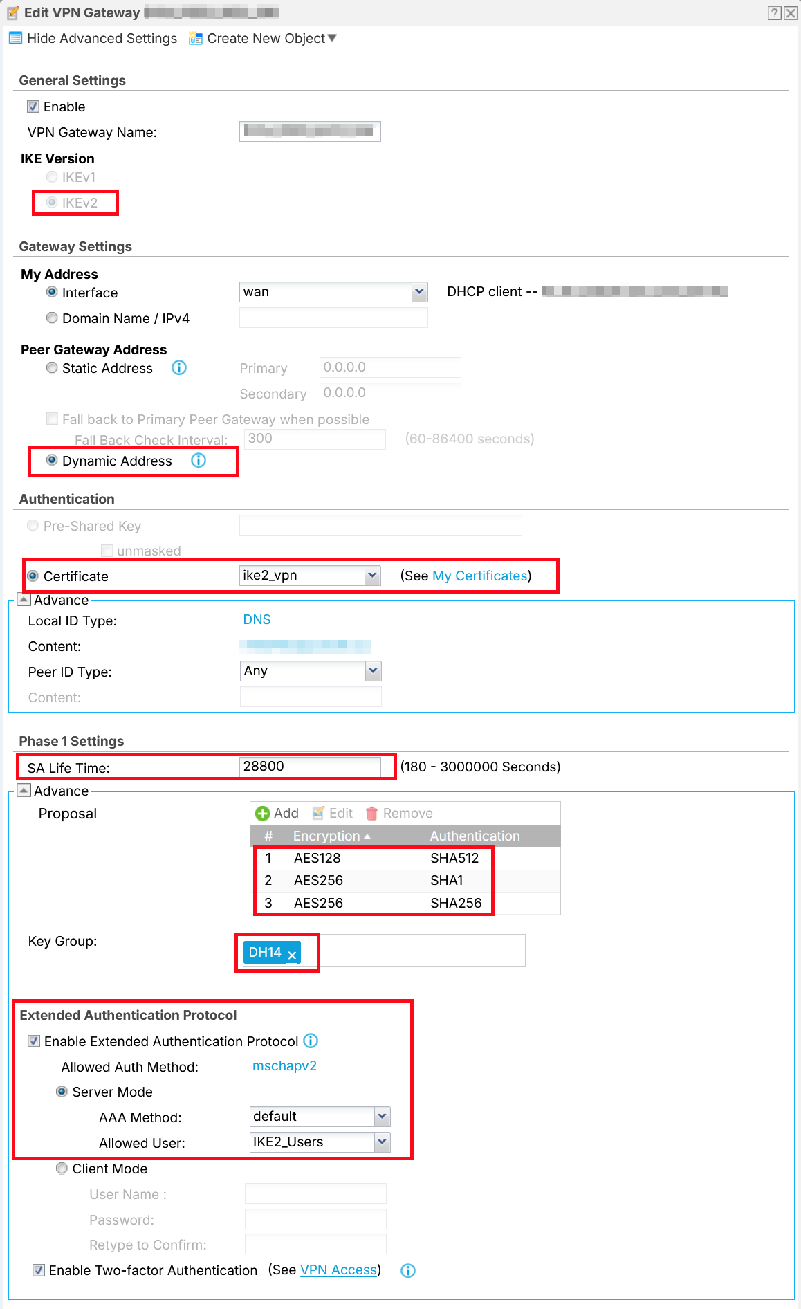

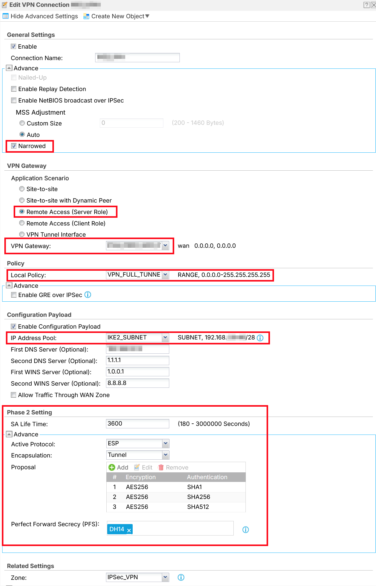

    Gateway:
    VPN:
    On the client device, the VPN certificate from the router must be installed (Trusted CAs store, Computer account context; this also applies to iPhone and Android), and the following must be added to the Windows registry (then restart the computer):
    [HKEY_LOCAL_MACHINE\SYSTEM\CurrentControlSet\Services\RasMan\Parameters]
    "NegotiateDH2048_AES256"=dword:00000001
    Then configure the native Windows VPN client and set the VPN type to IKEv2.
    If anything is unclear, any modern AI chatbot will be able to help you.
