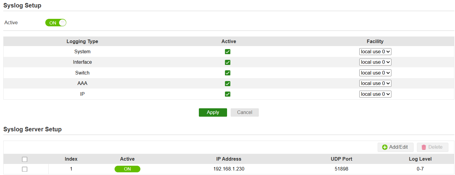

hi,
I configured syslog as follows and have a linux system on 192.168.1.230 port 51898 UDP listening for logs, but none are reveived from the switch.
I regularly receive logs from other systems on the linux syslog server above….

    Hi @grip ,
    Based on your screenshot, the Syslog configuration on your XMG1915-10EP appears correct. To help us identify why the messages aren't reaching your server, please try the following troubleshooting steps:

    Hi @grip ,

    Hi,
    sorry for the late reply; the switch did send the syslog messages correctly as configured, the problem was that this messages have the old RFC3164 protocol format that Grafana Alloy does not understand.
    I had to start a rsyslog server and forward the messages to the Alloy listener with this rsyslog configuration block:
    http://*.* action(
    type="omfwd"
    target="192.168.1.230" # replace with server hostname or IP
    port="51898"
    protocol="udp"
    Template="RSYSLOG_SyslogProtocol23Format"
    Hope it will help someone with the same problem.
