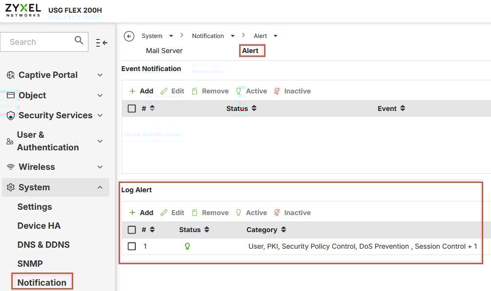

I'm testing email notifications and I get the impression that the 200H isn't sending some of them.
Part 1. "Log Alert" - "DoS Prevention" notifications.

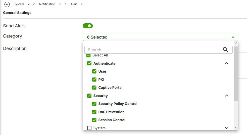

I defined a "Log Alert" that includes all "Authenticate" events and all "Security" events.
This was the only notification defined in this test.

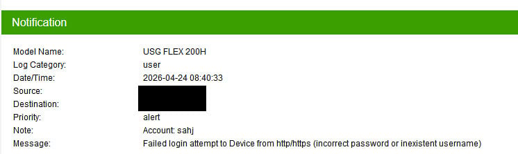

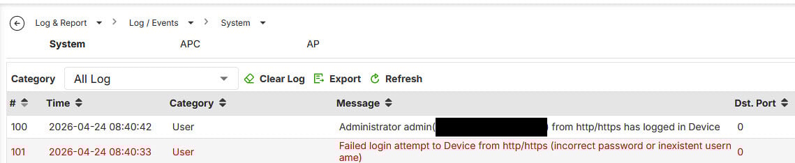

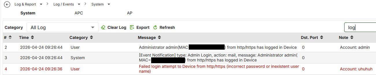

Next, I intentionally entered incorrect login credentials into the device. Next, after logging in successfully (as an administrator), I checked the event log and the login error was indeed recorded there.
I also received an email notification about the failed login.
I did not receive a notification about a successful login (as an administrator).

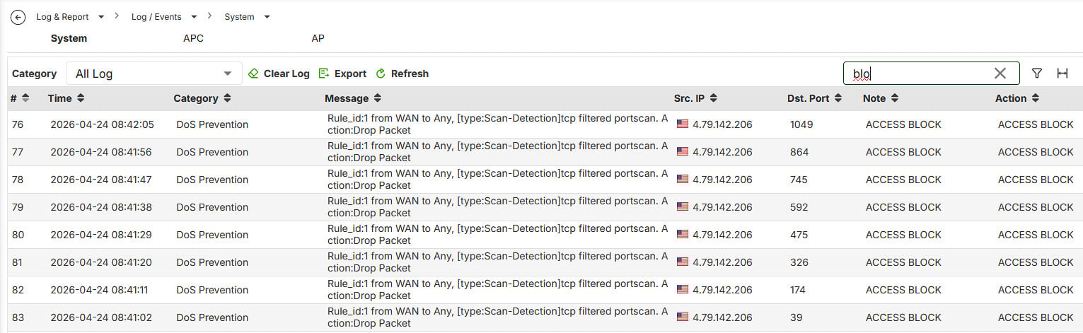

Next, I performed a port scan using the "ShieldsUP!" service. The test was successful, and the port scan was logged in the event log.
However, I did not receive an email notification.

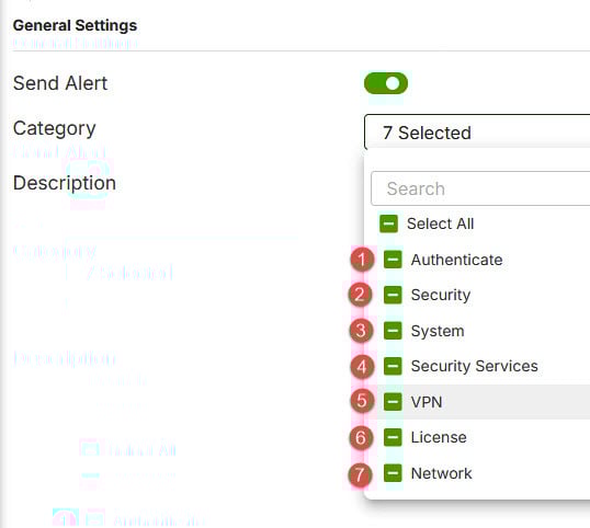

And one more general question: why can only 4 "Event Notification" alerts and only 4 "Log Alert" alerts be defined?
This limitation forces me to group alerts for different events, which I would prefer to have defined separately.

    Thank you for your feedback.

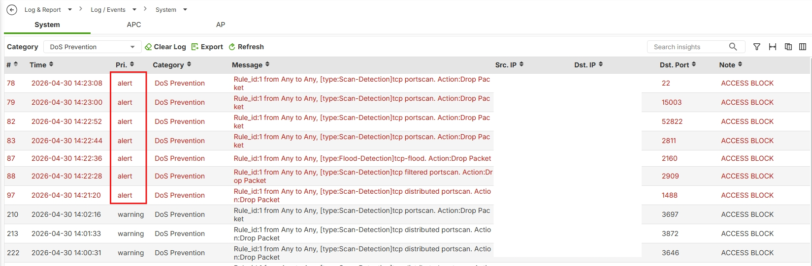

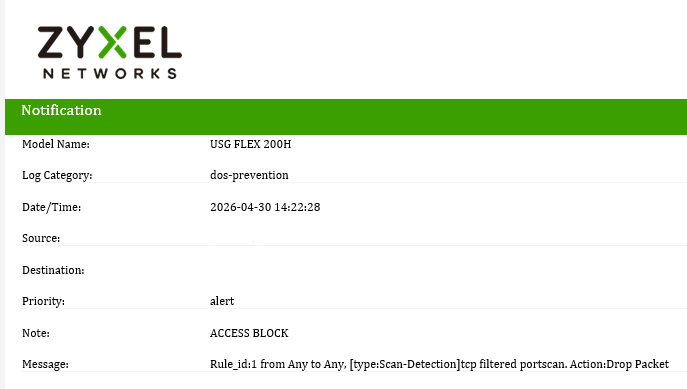

    Our testing shows DoS Prevention notifications are sent successfully. Could you please double-check your configuration, especially the Log field in the DoS Prevention profile?
    It should be set to "Log Alert". If only "Log" is selected, events will be recorded locally but won't trigger email alerts.
    Additional verification: In the logs, when Log Alert is correctly configured, the priority field will show "alert" (not just "warning").
    Please refer to the example image below showing a successful email notification.

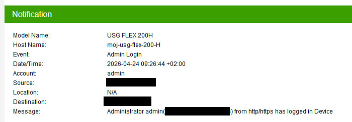

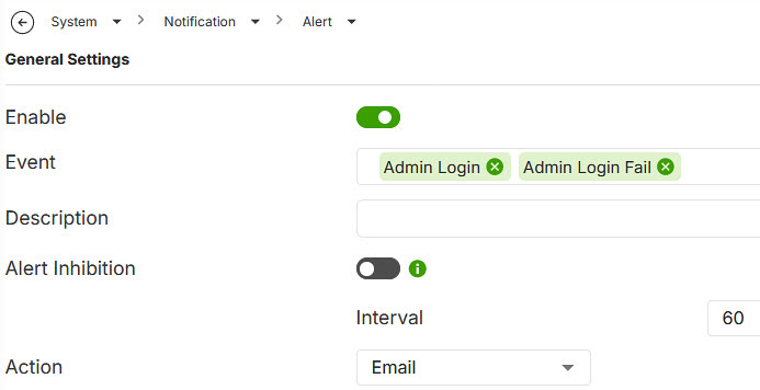

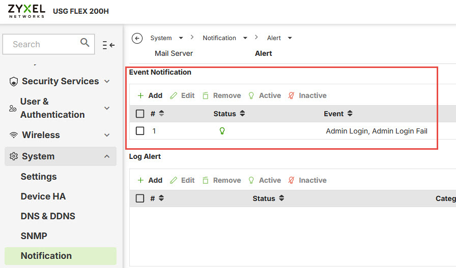

    I think I know the answer to question 1.1.
    The login error was related to the user account (I entered random letters).
    I received an email notification because "Log Alert" - "Authenticate" applies to users.
    However, I did not receive an email notification about a successful login as an administrator, because notifications regarding administrator logins must be configured in "Event Notification".
    I apologize for the confusion regarding this matter.

    2. Ideally (in my opinion), it would be best if we could define as many alerts as there are event types (i.e., 7).
    This would allow us to define alerts where the email notification title itself would indicate what the notification is about.
    With a limit of 4 and the grouping of alerts from different categories, it is difficult to define an unambiguous email notification title.
    But the information about the possibility of configuring additional alerts in NCC is sufficient for me.

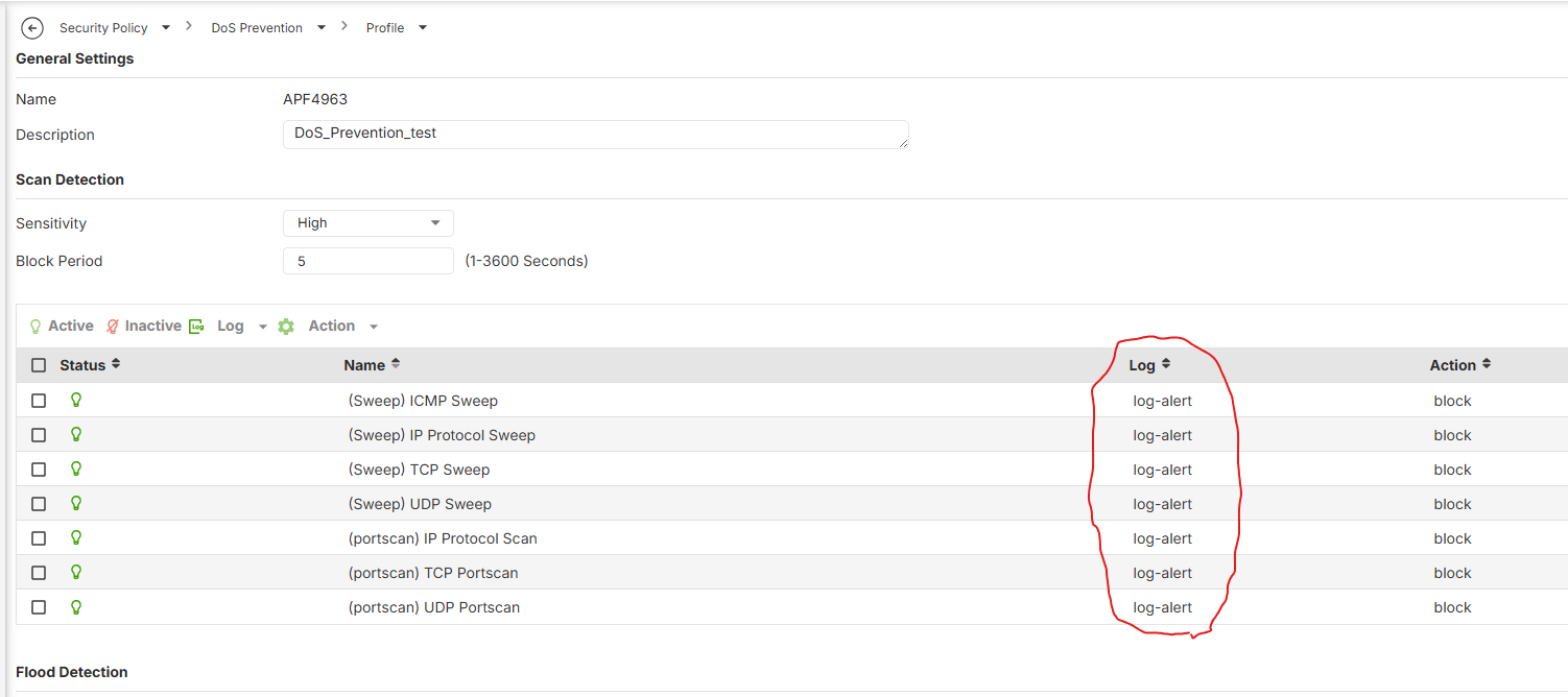

    Zyxel Tina

    Of course, you were right: I had the “log” option selected instead of “log-alert.” After changing these settings, I'm now receiving email notifications.
