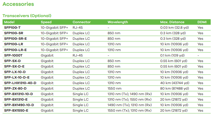

  • Zyxel_Tina
    Zyxel_Tina Posts: 1,045
    Zyxel Certified Network Administrator - Security Zyxel Certified Network Administrator - Switch 250 Answers 500 Comments
    image  Zyxel Employee
    edited May 7
    Hi @yang995,
    Please note that since you're using third-party transceivers, our support is limited. As XiLeiHaLo suggested, we also recommend manually setting both switches to 10G full duplex to check if it improves link stability.
    You can also check Monitor > Port Status > DDMI > DDMI Details to review the DDMI thresholds. If any parameter exceeds the high/low thresholds, an alarm or warning will report, indicating a potential issue with the transceiver or cable.
    Please ensure that the SFP transceivers on both ends are the same type (e.g., both SFP-LR or both SFP-SR). Mismatched transceiver types between the two switches can cause link instability.
    Since you mentioned testing with a DAC, ensure the correct media type is configured as DAC on the XS1930 switch. If the issue persists after the above troubleshooting, please consider using Zyxel-certified transceivers for optimal performance and full support coverage.
    Thank you for your understanding!
    Zyxel Tina

    Hi @yang995 in my experience I used OM3 cable for 1 Gbps connections, even OM3 should be certified for 10 Gbps up to 300 mt length. Could you try with OM4 or OM5 cables?
    Did you tried to specify media-type, like Tina suggested you?
    I never had issues with third party transceivers and Zyxel switches. I buy it on fs.com when they are not available from Zyxel.
