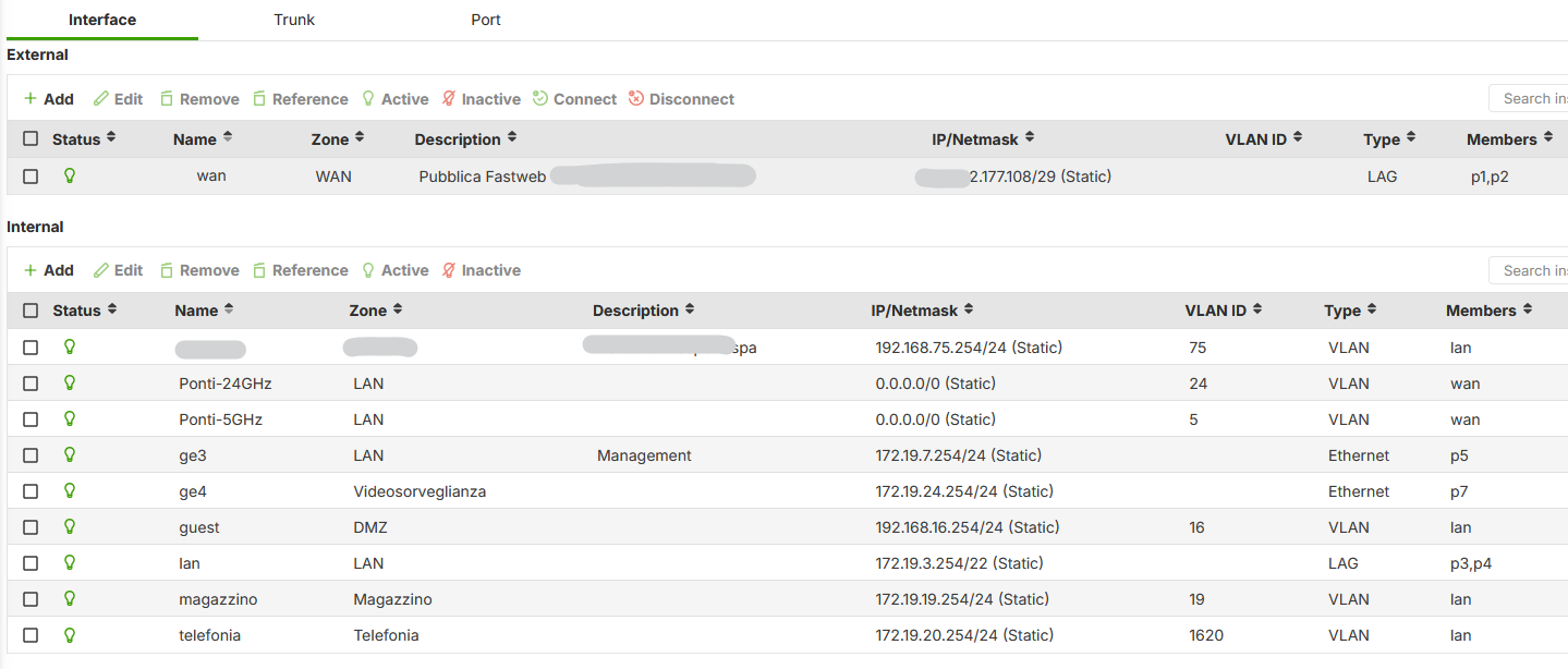

Hi Tina, it was a separate interface: I was in the following situation (just covered name ad IP address of my customer):
My PC was attached to ge3 interface, and I was editing "lan" interface, but the same happened this morining editing "wan" interface..
