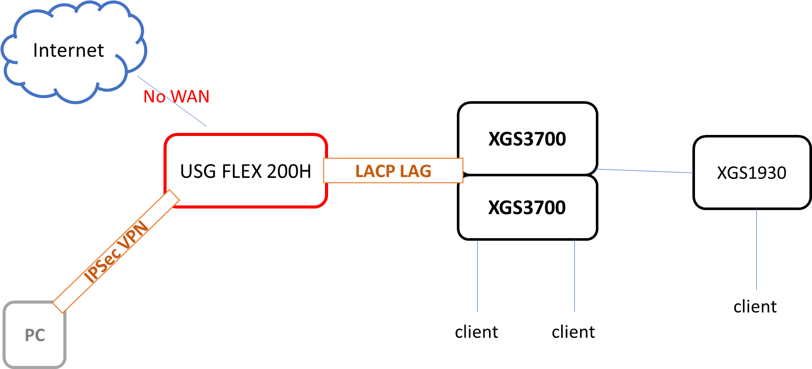

    To further investigate this issue, could you please help clarify a few details regarding your setup?
    • Could you please verify if your network topology matches the diagram provided below? image.png
    • If our understanding of the topology is correct, we would like to confirm the timing of the symptoms. Were the issues you described—such as the loss of WAN/Internet connectivity and intermittent IPsec VPN access—only experienced while the WAN LAG was configured as LACP (prior to the change)?
    • Additionally, please help us confirm that since you switched the WAN LAG configuration to Static on both the USG FLEX 200H and the XGS3700 stack, the packet loss and disconnection issues have stopped and have not reoccurred?

    Hi @Zyxel_Tina your topology is correct and I confirm both of your sentences.
